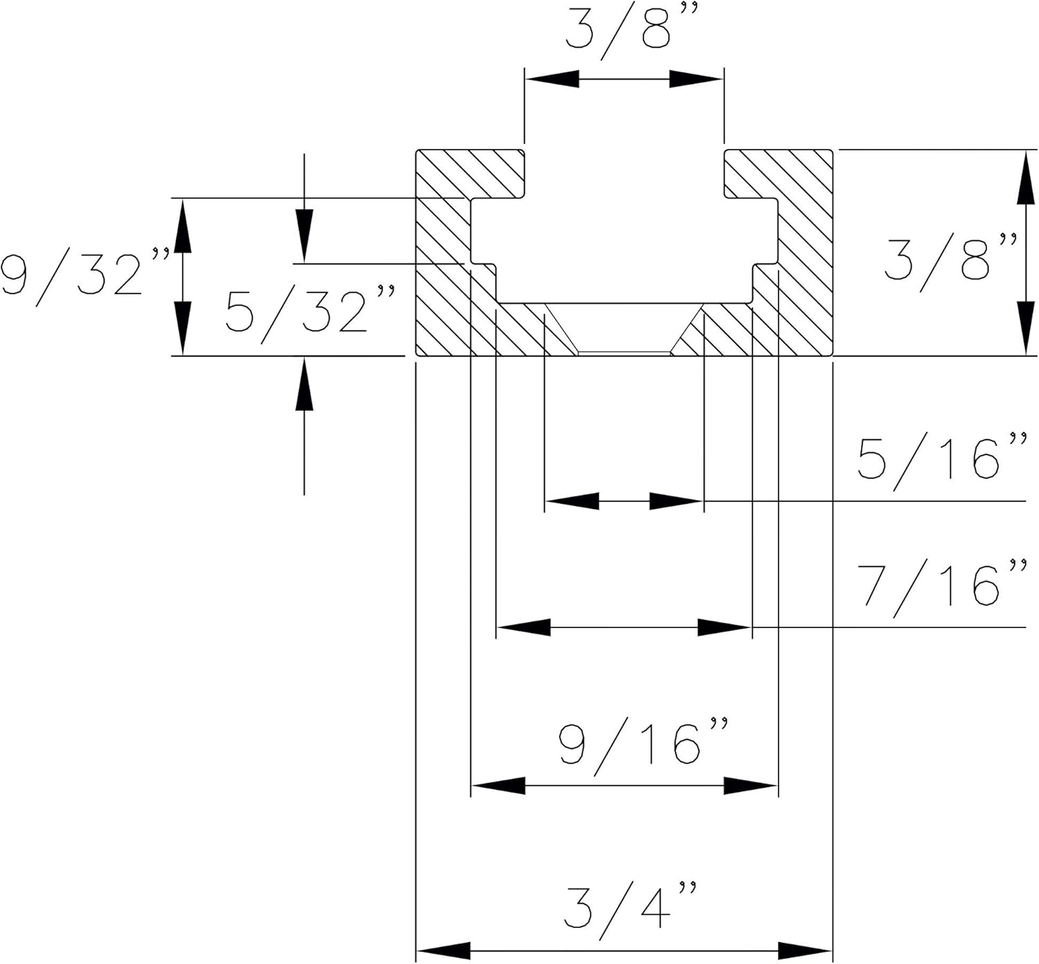

Where does everyone get the t-track from? Do they use 1/4" or 5/16" ?
As mentioned, I've got them from Lee Valley, I used 5/16". Fixed them in place using Gorilla glue and screwed them down every 12". They have proper t-slot bolts which slide better, but suitable bolts with regular hex head work as well... At first, I planned to use those plastic thumbscrews but later realized they require more space so now I'm using simple wing nuts...
I am using tracks for standard 3/8 bolts. These are strong enough to secure the reloading presses and heavy vises and also you can easily find bolts of any height to use with the knobs. Powertec is a good option, but not the only one.
POWERTEC 71119 Double-Cut Profile Universal T-Track with Predrilled Mounting Holes(2-Pack), 36" here is the link https://www.amazon.ca/POWERTEC-7111...r_1_5?keywords=t-tracks&qid=1588096318&sr=8-5
