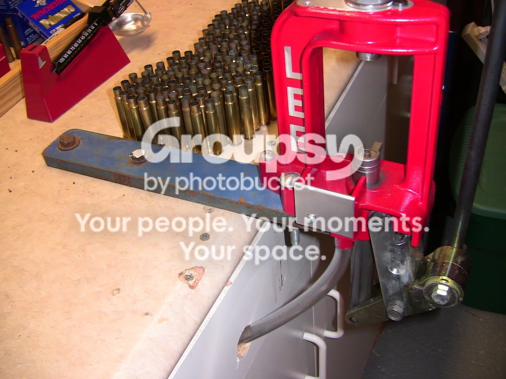

, finally gave up and grabbed a piece of 5/8 thick steel flatbar from the garage drilled it and bolted the press to that with 1/4 inch bolts, then attached the bar to the countertop wih BIG lag bolts, then further reinforced the countertop with more big screws into the wall and such,

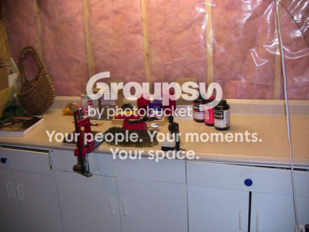

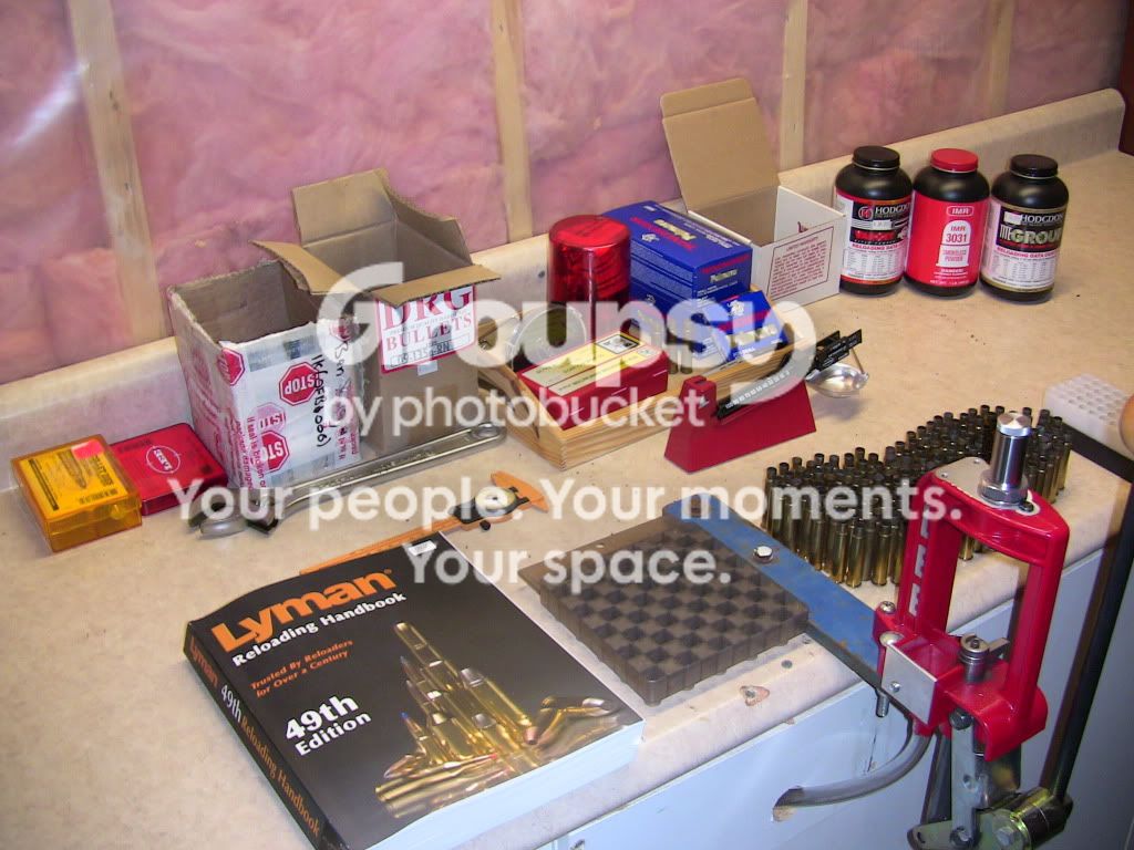

Heres some pics of my reloading room:
(And no i dont store my primers and power like that i just organized it up quick for the photoshoot
Bolted down good and some .303 british cases ready to be loaded

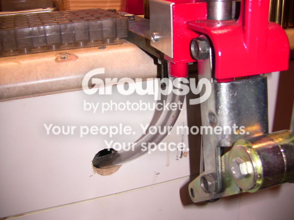

And this tube i rigged up off my press to catch spent primers and funnel them through the cupboard to a collection box inside
