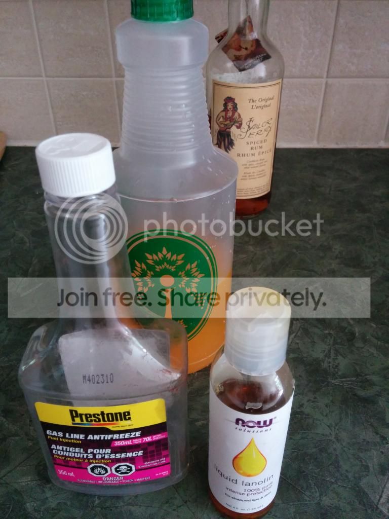

It works well? You never had any issues?
Never...
I suggest warming both your liquid lanolin and isopropyl before combining.
I've had a bottle of sit for a year... It remains solute. Nothing settles out... no need to agitate before use.
I use the small dollar store spray/mist bottles to apply.
Never...
i'm going to give it a try... thanks.
the rum is for me ;)
