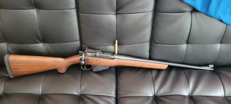

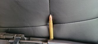

Hi Archibald I just came across this post.
Your cartridge looks very similar to mine.
It's a blown out 303 necked up to. 375
Called the 375 Jennings the gunsmith who made it. Mine is in a LE NO.5 action I have worked up loads using 9.5x56 data. So far have only gone up to 44 gr. 3031 with a 260gr.
Still no pressure signs. And pretty mild shooting. Just my 2 cents
What's the brass length on that round you made?

To be honest I have never checked it after fire forming the case. It's just a standard 303 blown out straight and then necked to. 375
It was a Canadian gunsmith here in B.C. who made it I was just lucky enough to get one.
I think he only made about a dozen.
