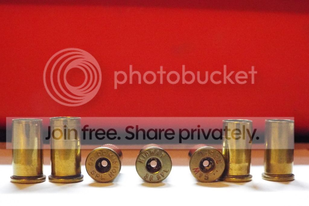

I call B/S! Won't split every time. I've loaded .38Spl cut down with out the splits in my H&R .38 Defender. These cases have been loaded 2X and are ready for a 3rd. 158gr SWC with 2.6gr HP-38.
