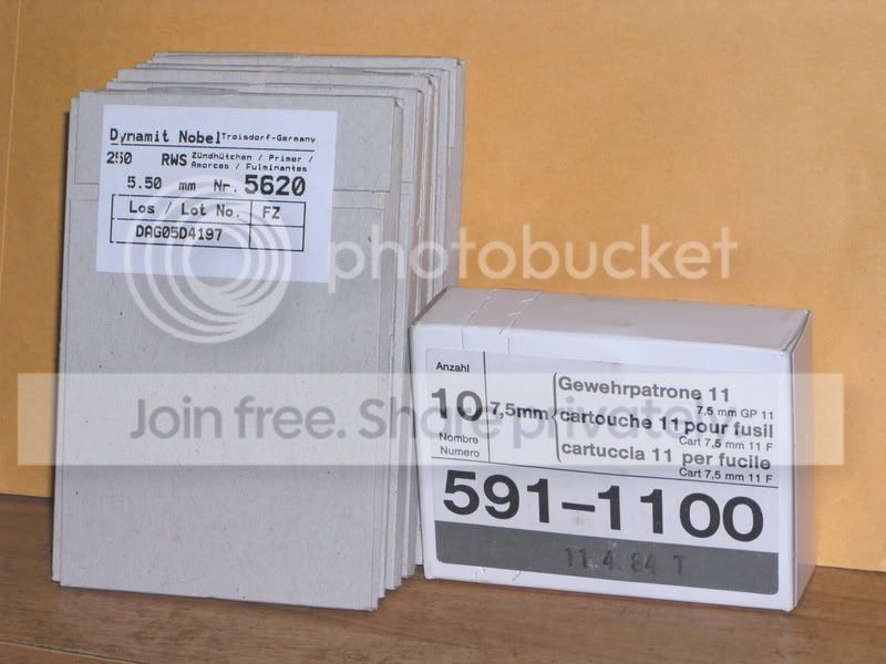

I am using RWS 5620 berdan primer for Gp11 brass. Have not tried the cheaper ones while I still have the RWS supply.
Dies: Have Lee, RCBS and Hornady 7.55x55 Swiss. Hornady is most used.
