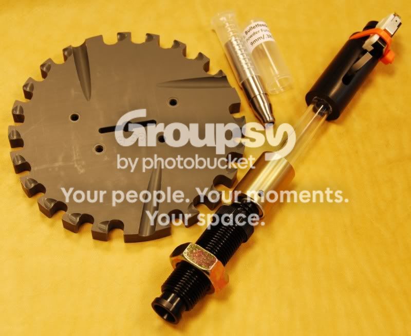

I have a couple of suggestions for the new bulletfeeder. The unit is fantastic, but the dropper die needs more weight to fully close. as it is, I am seeing 3 bullet drops at a time.
But a small pair of vicegrips added to the brass weight solved that issue, but it looks soooooo damn fugly on the die.
it's so close too, just 6 more oz of weight would have been perfect, the die would function perfectly on its own.
I tried adjusting so the bullet barely dropped, and I was getting skipped drops.
I tried adjusting as per the directions and I would see 4 bullets drop.
I tried changing the cotter pin position, changing the DAA Powder die.... same results.

OK, didn't see this before my PM. We definately need pictures of the bullet dropper. (DAA Powder die?)
Edit: Ah, just saw the video on the new style dropper.

Did you move the balls in the dropper and try the lower position also, i was talking with Rick and he does recommend that the balls go in the upper holes unless you are using every short bullets... I only have the one of the droppers in .45 cal but have not used as of yet...
The glue did not hold on my dropper either, any chance yours is moving where its glued togeather?
Looks like this...
I think he is refering to the powder dropper that goes in the powder die...
I'll try changing the ball positions and see if that helps out.
JOJO, the powder drop supplied by DAA works fine. Ingenious how they shaped the funnel so the bullet drops on the 'shoulder' of the case and doesn't move when indexing. Cool as heck.
Yes the powder drop works very well compared to all others I have tried for sure...I have way less bullets falling when I use it and thats where allot of the speed in reloading comes from... :)
I love how it does not over stress the brass also, its hard to tell if it even been flared after it comes out of the powder staition...
Hey i just had a thought, why not just pull the clear tube out of the brass bullet dropper where you now have your vice grip and use that over sized nut
that came with it as a weight and glue it back togeather, it would look better than the vice grip...
I found the solution. After lowering My balls (on the dropper) and tweaking the spring so it hangs looser, all is well.
