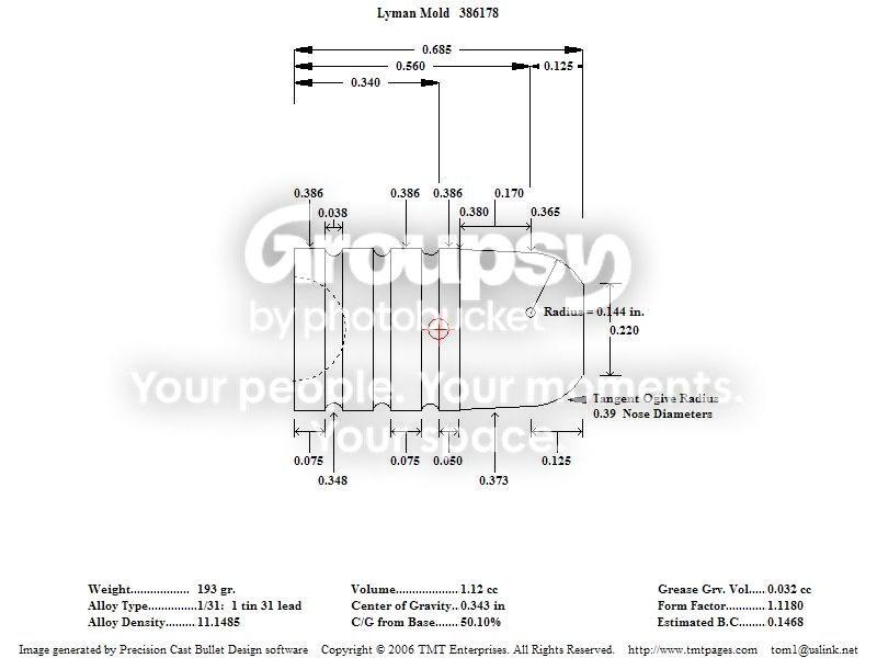

Sorry I somehow forgot to mention the bullet specifications. They are 200 grain, heeled, lubed, and are .386” diameter.
41 Colt were you using the 1892 or something else? Did you ever go higher than 4.4 grains Unique?
I hope that's .386" at the heel and .41 in front of that?

I found the heeled a PITA to crimp and lube. I ended up making a custom crimp too that works quite well. Found, you can have my crimper if you do not already have a tool made, just pay the shipping.
All the bullets I have ordered come in lubed like this.
And when I reload I use these specifications.

Am I missing a step here? The bullets when completed look like the pictures below.
Yes, those are hollow base, although with a much shallower hollow then I used (Rapine Mold) and found Unique to work fine.

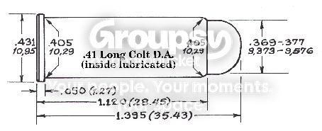

Here are photos of a different caliber bullet but it is a heeled. The lower portion of the bullets is smaller and it fits inside the case, while the rest of it is the same diameter as the case, like a .22LR, with the lube on the outside.
They need to be crimped and lubed one by one after assembly.

Thanks for the pictures and explaining heeled bullets, I have read about them before but did not pick up the "The lower portion of the bullets is smaller and it fits inside the case, while the rest of it is the same diameter as the case, like a .22LR, with the lube on the outside."
