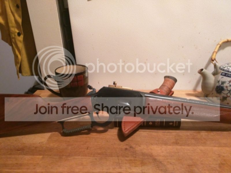

The Rifle:
I ditched the scope and put on a set of skinner sights, incidentally you will need their taller front sight to go with the rear, as the original Marlin bead is not tall enough.

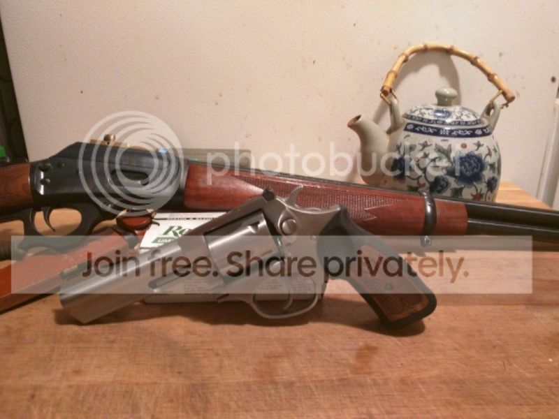

The Pistol: This is the Ruger 4.2" SP101 that digest anything the rifle doesnt like with gusto.

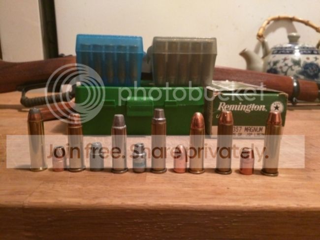

The Bullets: L-R, Rem 125gr JSP Factory, Hornady 140gr xtp, Hornady 158gr LSWC, Cactus plains Hardcast 158gr LSWC, Berry's 158gr Plated RN, Loaded .357 158gr XTP, Campro 158gr Plated SWC
Each of the bullets presented its own set of problems.
XTP: Actually these presented no problems at all, I shot 125, 140, and 158gr XTPs over a multitude of powders with loads ranging from good to extremely accurate. Of all the bullets I've tried the 158gr XTPs are my favorite, with a stiff load of Lil Gun getting close to 2000fps these bullets are my first choice for any serious work.
Hornady 158gr swaged LSWC: Shot these in both Plain and Hollowpoint forms. They would jam up the action pretty often with the shoulder hitting the edge of the chamber. Even in .38 cases they were jamming. They also shot pretty inaccurately with the faster pistol powders (HP38, Titegroup, Unique, etc.). I didnt bother trying these with magnum powders in the .357 cases.
Cactus Plains 158gr Hardcast LSWC: The first problem with these is when theyre loaded in Marlin cases the OAL is so long they'll hang up the action sometimes. The only way they'll feed reliably is loaded in .38 cases. With all the powders I tried, in either .38 or .357 cases I could not get these to shoot any better than 4" at 50yds. The revolver loves them in any form.
Berry's 158gr Plated RN: First problem with these is they wont feed when loaded in .357 cases, the RN is just too long and you need to crimp on the flat shank so you wind up with waaay too long an OAL. In .38 cases they feed like greased lightning. You need to give them a strong crimp bending into the plating, this is so the crimp holds the bullet in place from all the pressure on its nose from the preceding bullet in the magazine tube. A mild crimp invariably results in bullet setback once theres more than 3 in the tube. They dont shoot very accurately in the Marlin anyway. My favorite load for the revolver is a stiff .38/44 load of HP38 behind these RNs, crimped hard, these fall out of a speedloader like magnets.
Campro 158gr Plated SWC: This bullet is perfect for the Marlin. It crimps high so the nose is short enough to feed in .357 cases no problemo. The crimp groove allows you to apply a strong crimp without compromising the plating. The profile is actually quite similar to the XTPs I love so much. Apparently these are thicker plated for better results at rifle velocities too. How do the shoot, well thats exactly where this post is going...

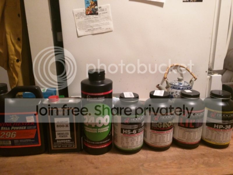

The Powders:
Well as promised heres a couple of loads I tried.

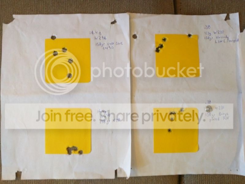

My first testing was at 25 yards. As many lead loads Ive tried previously were pretty bad at this range its a reasonable testing distance.
The Cast H110 load grouped exactly as I was expecting, not very good. I havent chronied it in the Marlin, but it shoots about 1240fps in the 4.2" SP101
Also the Hornady XTP also performed as expected, this is also quite accurate at 50yds.
The swaged HP38 load also grouped as expected. This load Chronys at 1038 avg from the 18.5" Marlin and 830avg from the 4.2" SP101

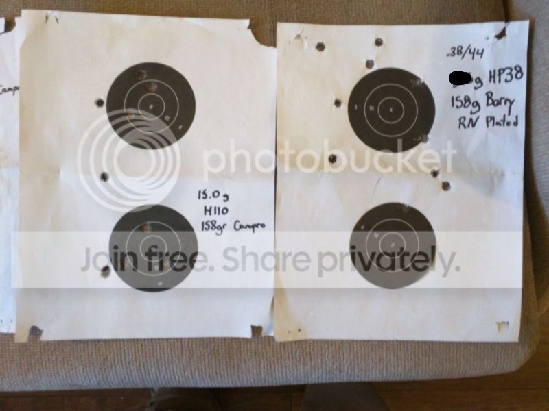

The Plated .38 load consisted of a .38/44 level load of HP38, I wont specify as its well over +P pressure. My SP101 is quite accurate with them. This load Chronys at 1178 avg from the 18.5" Marlin and 937avg from the 4.2" SP101.
Looks like these Campros are promising!
Also strange that the Plated Berrys grouped quite well in this target, anomaly? Decided to try them at 50yds to find out.
These loads are quite moderate, as I'm working my way up.
Well lets head out to 50yds with the Campros
I quite like this load of 15.1gr H110/ magnum primer. It feels quite powerful. I think I'll load a few more velocity test it and try grouping it again. I did chrony this 15.1gr H110 load with the Berrys RN and it averaged 1660fps.
I wasnt impressed with the .38/44 Berrys RN HP38 load at 50yds, looks like the group at 25yds was an anomaly.

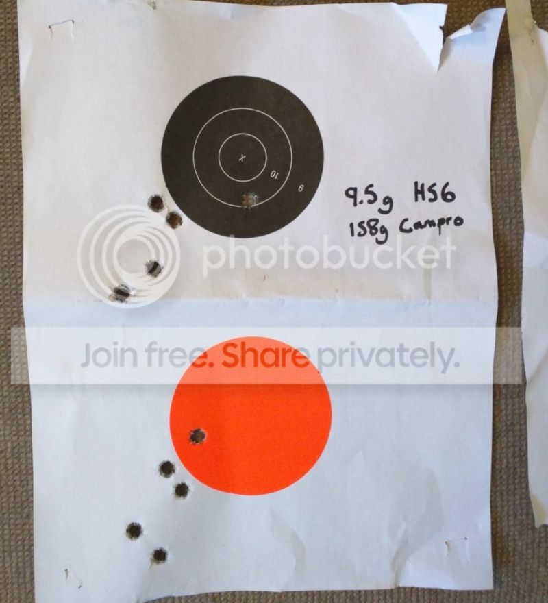

A max load of HS6 really didnt shoot that great unfortunately.

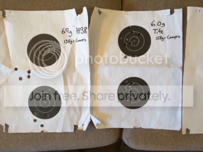

Although not very potent, this titegroup load shoots great, right at POA/POI and is economical. I will further test it for velocity and POI at 100yds. For plinking this load might be perfect. Unfortunately it is not terribly powerful, around 1200fps, it is pretty much max for pressure though. I'm loading up a few hundred of these to finally have some fun with this rifle.
Wasnt so impressed with the loading of the HP38 Campro SWC.
