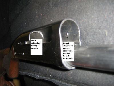

I notice on the 1100 I recently acquired that it has some play in the barrel.Even with the fore stock /mag tube nut tight I can still twist the barrel a fraction of an inch.Removing the barrel I see it has a groove on the outer left side that looks like it should slide into a tab in the receiver,Inside the reciever it looks like there should be some sort of guide that sits in the groove of the barrel but is worn down.Should there be a guide?if so can this be repaired?Or is the sloppiness normal for an old 1100?
