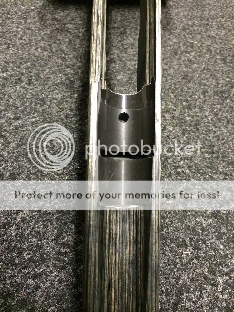

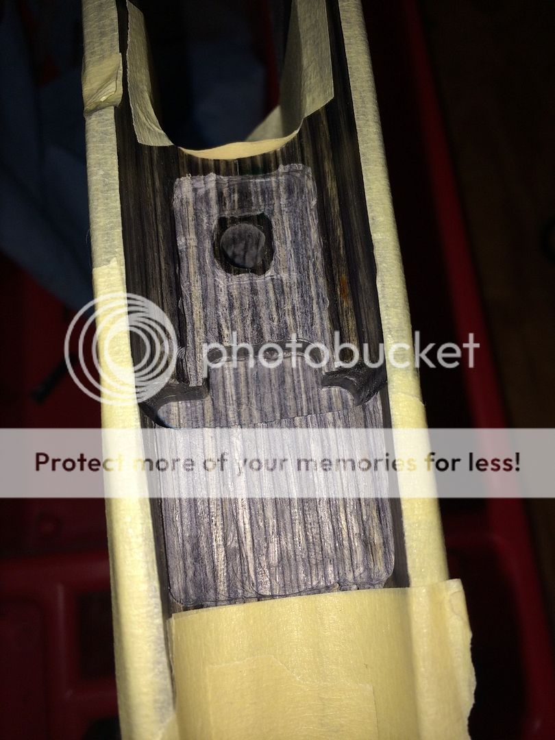

I found a nice laminated Remington factory BDL long action stock on the EE, it didn't have the cut out for the detachable mag, but I figured I could easily modify the stock to work with the factory DM set up...also, I thought I was due to try my luck at glass bedding (I used Marine Tex) for the first time.
I can happily report that it all went very well, the stock was easily filed, sanded etc. to fit the DM, the glass bedding job turned out great, with the barrel free floated of course.

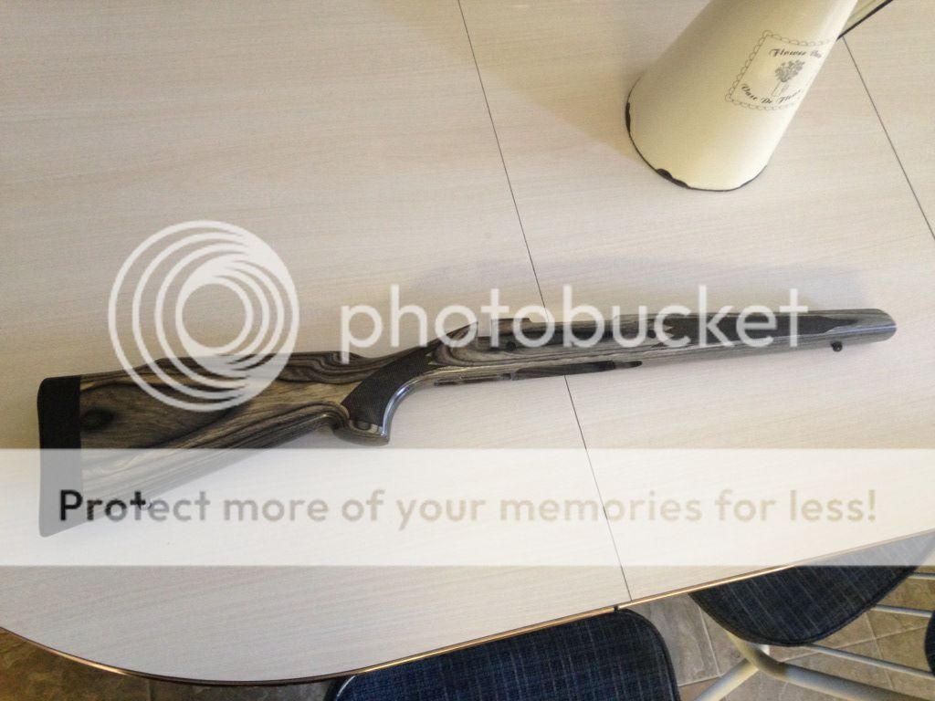

This is the stock before I got my hands on it...
After fitting for the detachable mag...
Prepped for glass bedding...
