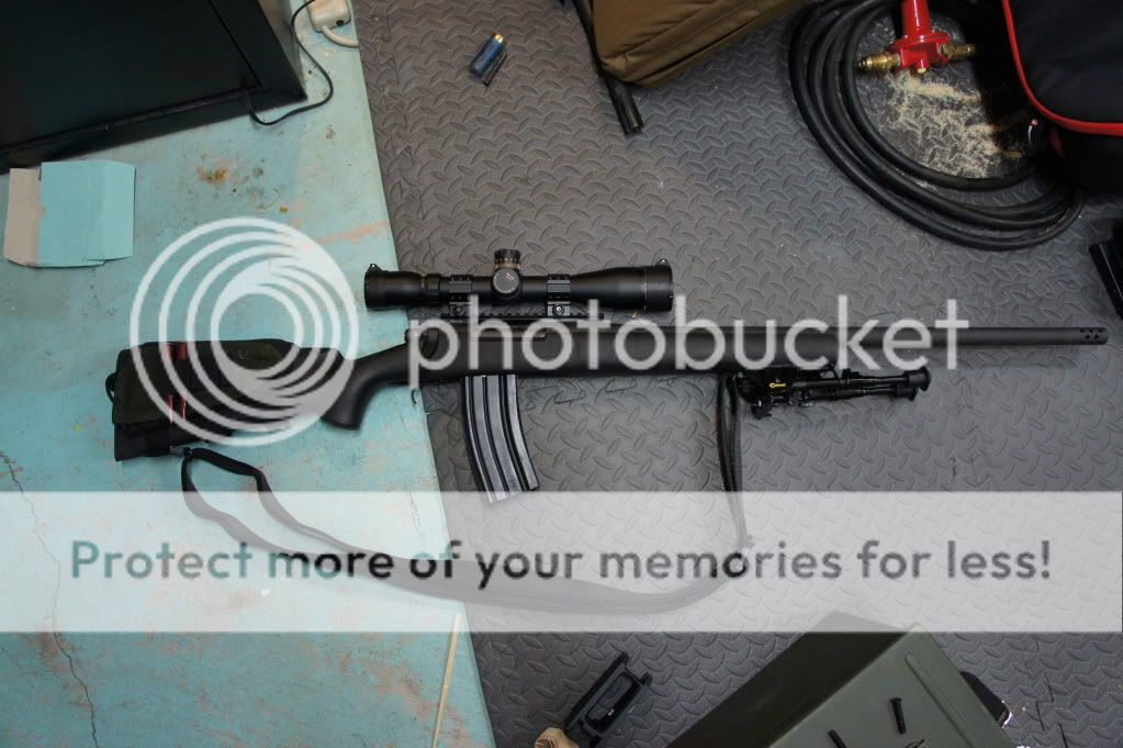

Here is the gun with the bottom metal removed and the magazine in temporarily. In talks with a smith over the best way to do the conversion legally so the magazine will not need to be pinned to 5. The most likely path I will go down is having the magazine permanently attached to the gun so it can not be argued that it is detachable and can be put into an AR unpinned.

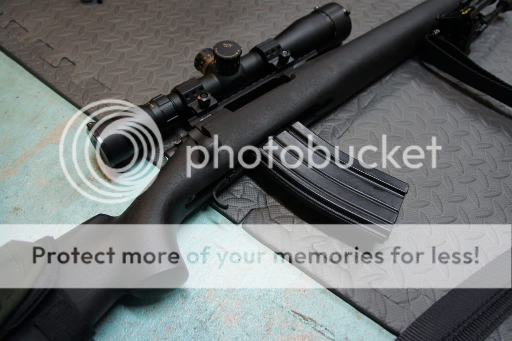

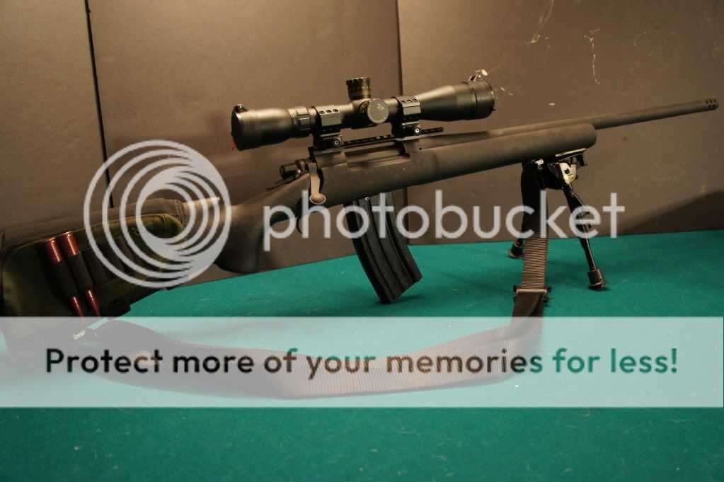

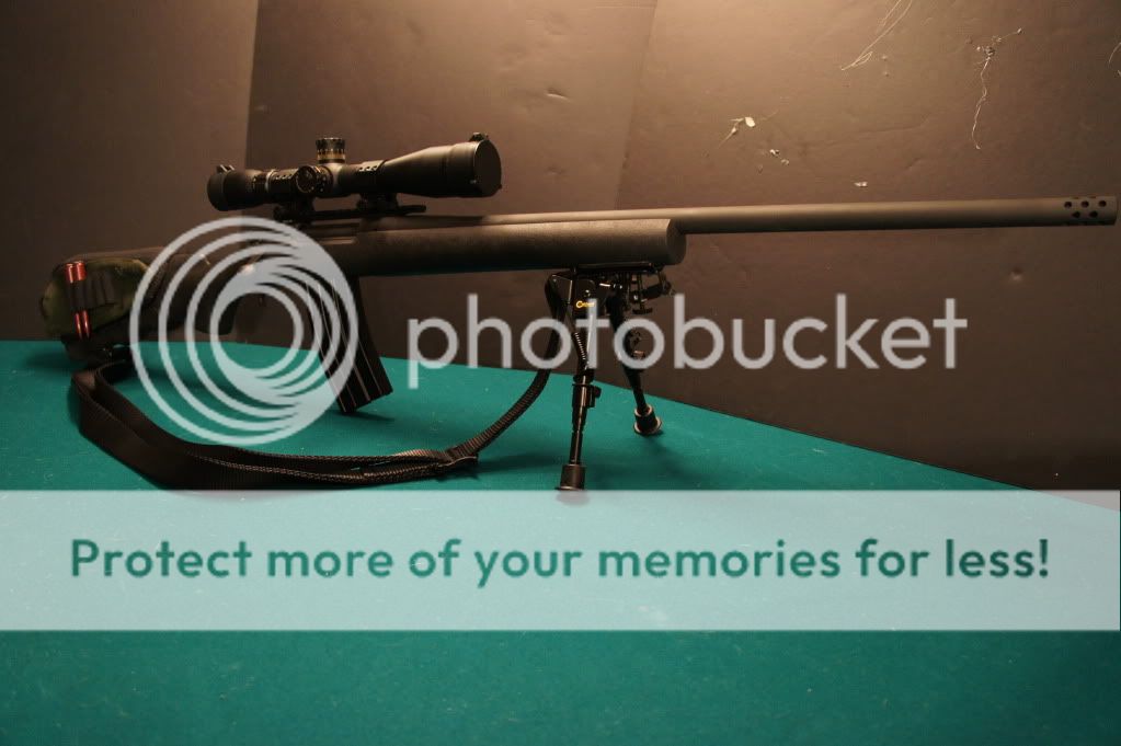

I was just messing around in my shop to see what would be involved in doing this mod. (I sense a money pit in my near future :p)
The scale of the rifle is a bit off because it is a .338 Lapua, not a .223, but you get the idea. The bipod is on the second lowest setting and the mag still does not touch the ground.
(So you know, I removed the floorplate to get it to fit.)
Looks like if I have a custom floorplate milled, this could work very easily.
The only thought I have is how to do the magazines. The way I see it there are three possible options.
1) Permanently attach the magazine to the floorplate. Ie. weld or similar method, and remove the pin. It would be cool to do it with a black windowed PMAG.
2) Have a detachable magazine, but modify the magazine so it will no longer fit in any AR, and will only fit in my magwell. Add materiel on the magazine? Maybe use a PMAG? (More difficult then option 1)
3) Have a detachable magazine that is either pinned to 5 or takes the LAR 10 rounder's. (Defeats the purpose, other then the side effect of having cheap and plentiful magazines. Not going down this track likely.)
Discuss.

I'd like to see someone shooting the rifle in the picture (with the mag) in the prone position. Somehow, I doubt it would work as the mag would put the rifle wayyy too high off the ground for it to work.
It wouldn't be too high. Do you think that the various militaries of the world would issue 30rd mags if you couldn't easily shoot in the prone? I shoot prone with a 30rd mag because it gives me a more stable platform than holding the weapon off the ground, if anything the rifle sits too low but the advantages outway the disadvantages for me.

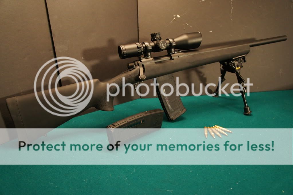

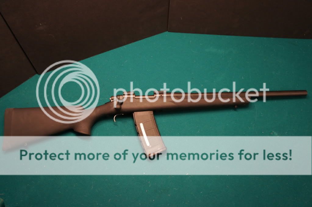

Alright, I have convinced myself I am going to jump in on this. Funds are low right now until the spring thaw comes and I start full time construction work again, but I am moving along slowly regardless.
Got 2 PMAGS with the Maglevel window from Blaxsun last night, and I put up a WTB ad in the EE. If you got a spare R700 SPS Tactical or 700P in .223 that you don't need... give it to a good home. :D
