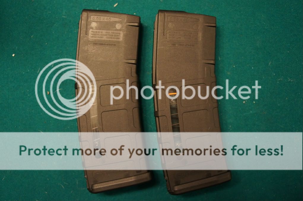

Mags are here. I have the Magpul Windowed 30 rounders with the "Maglevel", which is a painted coil on the spring that gives you an approximate count as to how many rounds you have left. There are numbers on the side of the window to help you gauge as well, 5, 15, and 25.
Really nice magazines. I can't wait until that orange Maglevel goes down past 25. :cool: (Legally! They will be either modifed to no longer fit in an AR, or just permanently attached to the floorplate.)

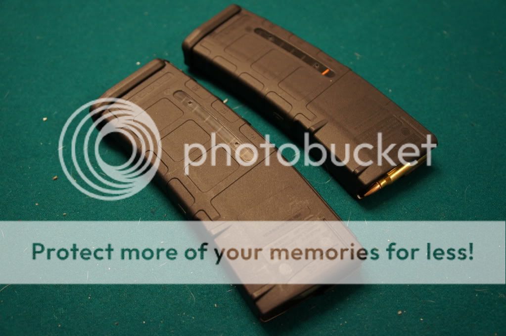

Picked up the rifle today.
Just a quick pic with the bottom plate removed so the mag will fit.
Even just like this, it feels so right. :D The magazine does not stick out the bottom nearly as much as I expected it to, a lot of the mag stays inside the magwell.
