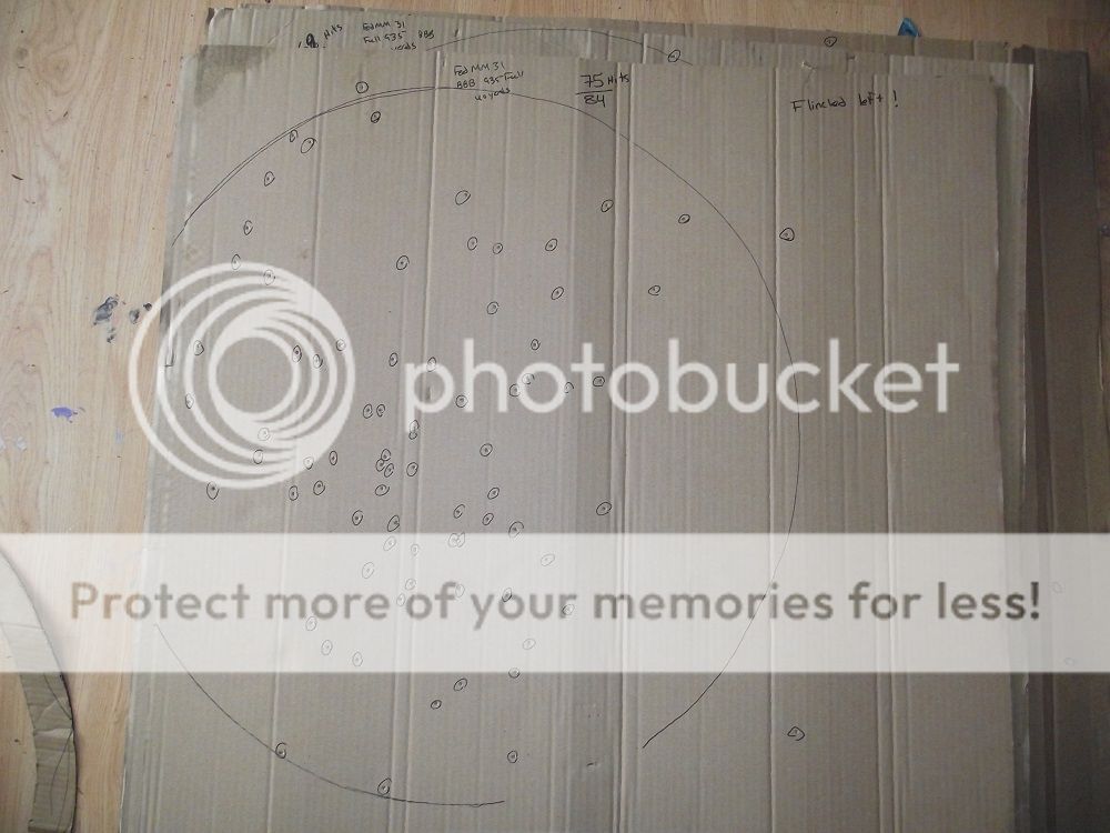

I do own own many quality guns, but my duck/turkey gun is my Mossberg 935. Works flawless and doesnt have any issues cycling any loads i put in it, including target loads.
As far as my statement about patterns, Im not repeating something I've heard or falling for some marketing tactic. Im basing my opinion on personal experience with my own firearms. None of my current Brownings, Beretta's, Franchi's or any other gun i have owned in my lifetime have been able to match shot patterns with my old 835 and my current 935.
And im not saying a 870 wingmaster isnt a quality gun. What I'm saying is that for the price, I'd rather have a Browning BPS because i know Browning guns fit me better and i personally think its a much better pump shotgun.
This has been my experience as well with my 935, I've shot over 250 steel shot patterns with different guns over the past few years and the 935 usually comes out on top.
Over boring does make a difference with steel shot patterns, if it didn't, manufacturer's wouldn't be increasing the bore diameter on their waterfowl guns.
No other gun Ive patterned will do this with BBBs at 40 yards, 89%

The reason some people see tighter patterns after getting their barrels averboard as an aftermarket feature is because they use the same chokes as before. By opening up the bore you are essentially making the constriction difference between the bore and choke larger. So a bore ID of .730" with a choke that is .720" has .10". Now you go and overbore the barrel to .742" and use the same choke you know have .22" of constriction.
if you shot the 1 3/8oz BBBs out of a .730 bore using the same constriction choke you'd a have blown pattern. likely swell your choke to due to shot bridging.
If you shot it with a cyl choke you might have better results, imo.
Agreed! I have had the same results. Have you ever tried to pattern T or buckshot? You'll be impressed my friend! I usually shoot BBB and T when pass shooting at Canada's and they are devasting. While I dont like pass shooting beyond 40-50 (max) yards, I have zero doubt that I would obtain clean kills beyond 50. I dropped a Greater Canada last year with a head shot at roughly 55-60 yards using 3.5" T's and it was when I went to retrieve the dead bird that I realized that more then half of that birds head was missing. Fine, large shot size = large holes. But what impressed me was that there were roughly 8-10 additional pellets in its neck and only 2 holes in the rest of its body. So assuming my lead was close to being on point, the shot density increase within the 1 foot between the tip of the beak and the upper breast was devasting enough to almost completely disintegrate a goose's head at what I consider to be a very long range shot on the fly. It would lead me to believe that the overbored barrel shortened the shot string, and thus putting more pellets on the target in less time. Lucky shot? Of course! I'm not one to usually take those long shots as I would likely miss 9 of 10 of them. But thats not the guns fault, just the operators ability. And on paper, 89-90% is a common place for me as well.
Sounds like its working to me! Although I'm interested in seeing this article you mentioned to understand the logic and physics behind the reasons, I'm more liable to believe what I have personally experienced first hand. My Browning has a .742" backbored barrel and I noticed marginally better shot patterns over some of my other 12g guns that have the nominal .729" bore using the same choke constrictions. The Mossberg 835/935 has a .775" overbored barrel which is the same nominal bore diameter of a 10g. And as mentioned, shot patterns continued to improve with the oversized diameter....again, using the same choke constrictions.

I wish it were that simple. First there is no way to increase "center mass" of a shotshell charge. That's a mathematical fact, and the goal of doing so is sort of the fool's goal of the shotgun world.
As far as the benefits of backboring, for every person that thinks that it is the cat's meow, there is another that thinks it is total bunkum--
Restarting a dying thread. While I dont have a picture of a shot pattern test of my 935 at the moment, here is a photo similar to what I mentioned in one of my previous post. This time the casualty was a wood duck. This bird was shot flying upward and away from behind. The shot was made between 20-25 yards. The ammunition being used was 2 3/4" winchester xpert, 1 1/16oz, #4 shot and the choke was a modified kicks high flyer. Not a single pellet penetrated the bird below the neck. Devastating hits like this are common on my 935 at these distances, and never occured on any other gun that I own. Its things like this that make me believe that the over-bored barrel does make a difference and the shorter shot strings on the 935 speak volumes
