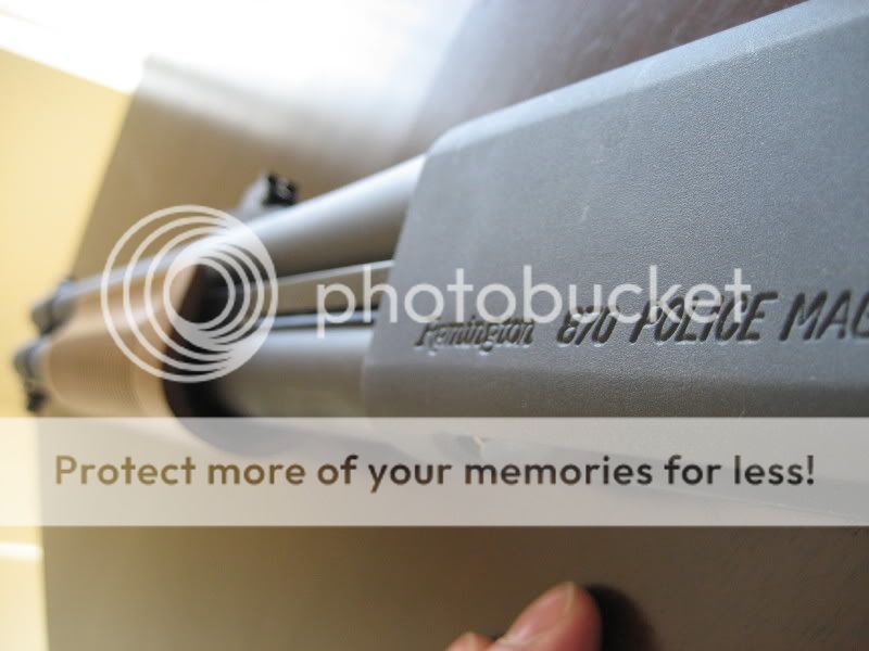

Pretty much correct. Some of the police configurations weren't marked "Police" or "Wingmaster." I have a blued 870 Police marked "870 Magum" that came with a 18.5" cylinder barrel and was designated an "870 Police" on the factory box.
