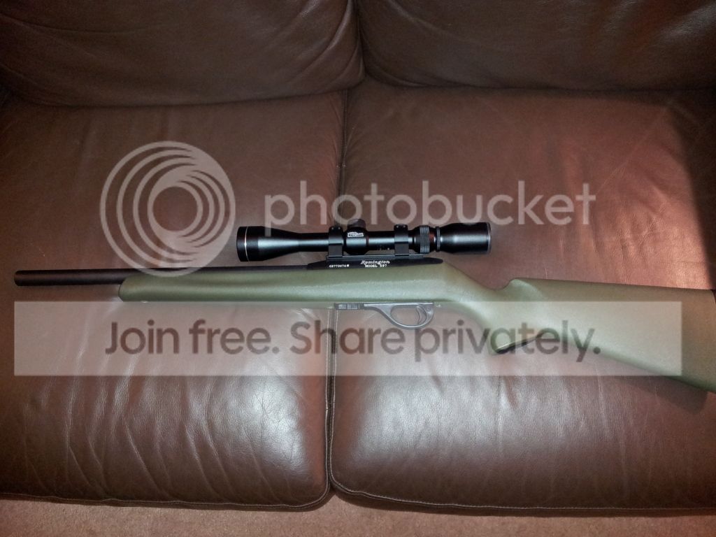

Decided I wanted a cheap starter rifle to get me in the swing of things and set my sights on the Remington 597 with Heavy Barrel. Picked that up on Wednesday, picked up a Tasco Pronghorn 3-9 x 40 scope on Thursday. Went to the range this morning and got it all dialed in and had some fun.
First off, the gun:

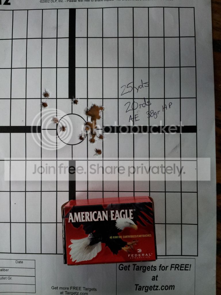

American Eagle 38gr Copper Plated Hollow Point

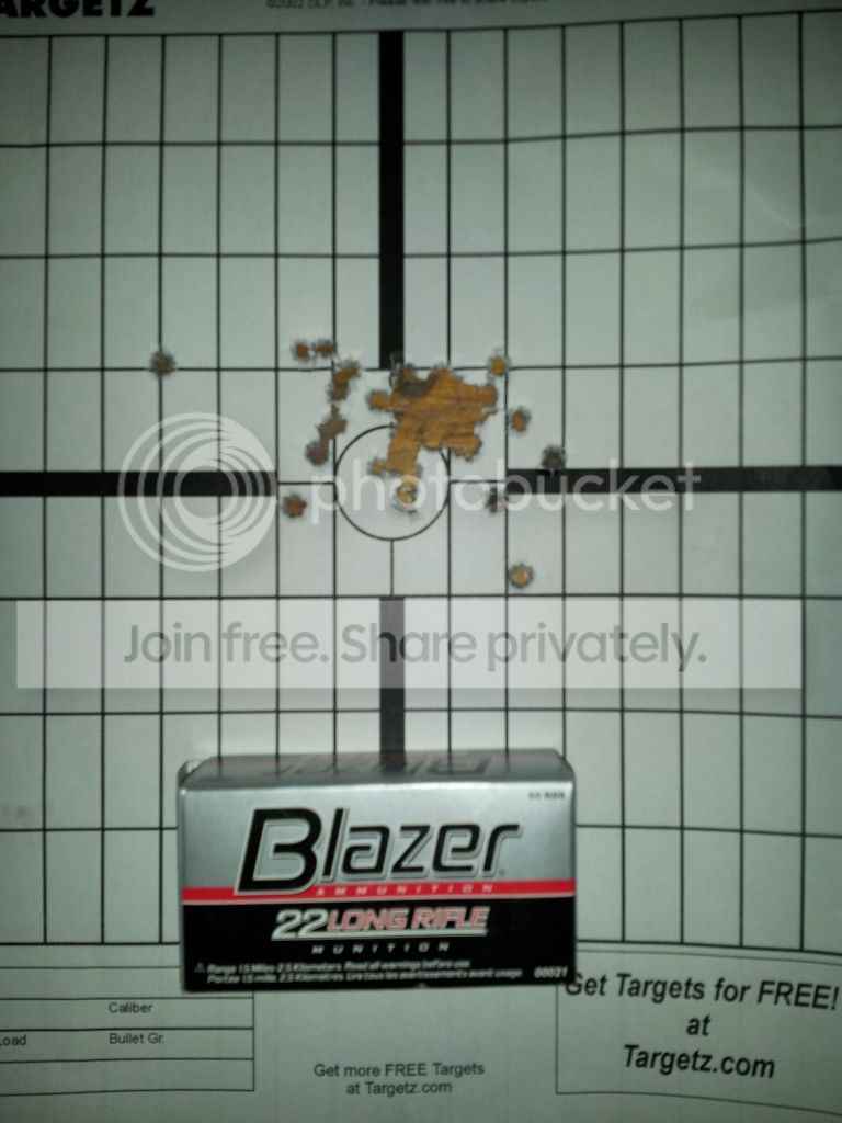

CCI Blazer Lead Round Nose
50 rounds of each, all worked great, only malfunctions I had were 4 failure to feeds with the Wildcat, rounds got stuck in the mag...needed a bit of a poke to pop up to the top of the mag.
This is my first time shooting a scoped rifle of any kind, I was shooting from a seated position at a bench without a bipod, bags or any sort of rest.
Here are two of my best groupings with the Blazer and American Eagle:
25yds - 20rds fired
25yds - 30rds fired
Very pleased with the rifle, it performed awesome. I blame the 4 FTF's on the ammo, the lead nose was a bit rough and I think that caused it to stick in the mag.
The scope I chose was due to price point and variable zoom up to 9x. At 25yards it was pretty clear at 9x, seemed a bit better at 7x, no complaints thus far.
Overall, HAPPY CAMPER. Hoping to get a lot more time on it and see those groupings tighten up!
