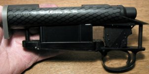

I’m trying to keep my posted pictures in sequence but the new forum software has me re-learning all over again. The first picture shows my bolts returned after the bolt knob threading process before the Loctite treatment. I left both knobs a few threads out so you can see the squarish Remmy bolt handle after the 5/8”x24 lathe process. It leaves a ridge with sharp corners and this can cause an unsightly and rude awakening on your hands.
The second picture is another view / angle of the knob / handle interface
Here’s Casey’s input; he makes his own Badger Ordnance style knob with a tapered / chamfered mouth to interface seamlessly with that sharp corners examine the shine off the mouth of the bolt knob in the third photo. I left it standing so you can zoom in on that chamfered surface! sharp ridges are now covered and no more threats to my soft retired teacher hands ! Yuk Yuk Yuk....
It’s a nice touch and I wanted to share such a fine and appreciated detail. Now it’s time to Loctite those babies down!

Just don't ruin the 700 by replacing the original enclosed extractor system.
I like a slightly smaller bolt handle blending in with some handle reshaping...
You are an incredibly cruel dude! Showing things like this that you no longer do. How the hell did you get that awesome look on the receiver? Im assuming some kind of bead or media blasting. Awesome looking
I like a little more to grab onto over the OEM 700 knobs as well. Some of the new production 700's come with a tidy upgrade. I've always just thrown one of those rubber ball knobs on the spaceship 700 knob, not pretty but they work fine.

OP,
Your Guru did not fix the known bolt handle/extraction issues w/ your short cam bolt handles.
You lucked out w/ your 2 TactiKool knob modifications as there doesn't appear to be inclusions/voids that are usually present.
guntech,
Nice blend job as per 60's vintage handle shanks.
Hitzy-
Notice the OEM Rem Tac handle's knob is parallel/offset w to the bolt centerline as per the original knob.
Most aftermarket TactiKool knob modifications, the knob is centerline to the handle shank (swept back)....knuckle buster...baseball bat extension.
Hitzy-
