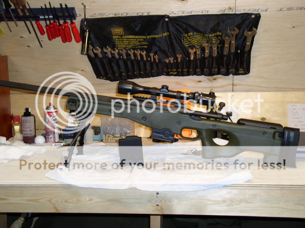

I have a 700 VTR in .308 and it is in an AICS stock with a Vortex scope. Great fun to shoot and quite accurate. Still playing with it, so no real numbers yet. Same set-up as the picture below. The pic is of my 700 in .223.
