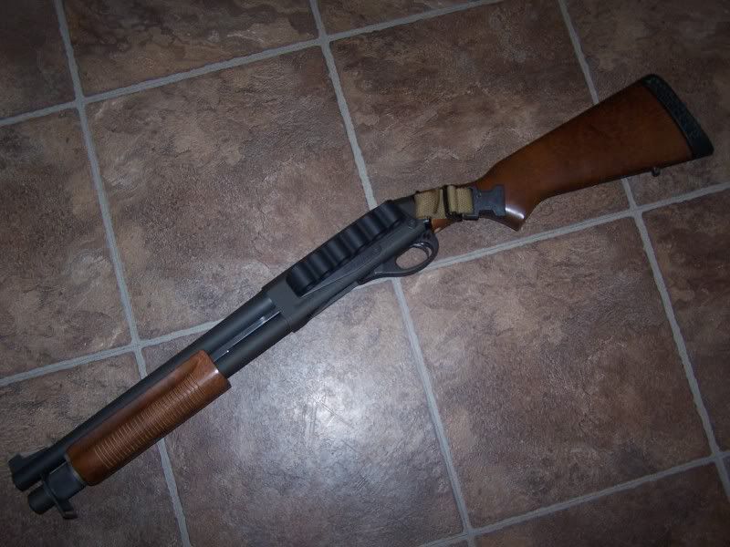

I just bought an older wingmaster with a 30 full choke for $200 and chopped it, added ghost ring sights ported the barrel and parkerised it in the garage. I am just about to pick up a litre of teflon to teflon coat it. Total cost about $350. I like it so much I built 2 more although since I had to buy the barrels as opposed to chopping them (12.5 and 14") they cost a little more but still less than $500. Parkerised them and they will be getting tefloned too. I don't hunt so I don't need 3" receivers and half the fun is adding the doo-dads. The pistol grip was just on for the picture, it looks good but useless otherwise.

Nice work. The price for what you did is even nicer. So between the Express and Wingmaster which would be considered stronger, or are they pretty much the same in terms of materials/construction? The thing that has always attracted me to the Police model is it's built like a tank, but they're not cheap.
the Wingmaster will have crisp and clean machining inside and out, and an aluminum triggergroup, chromed/polished bolt.
the Express will have machining far worse than Chinese 870 clones, a plastic triggergroup, and be vigorously bead-blasted to try and (unsuccessfully) hide the piss-poor finish.
otherwise, function/reliability is identical with the Wingmaster being smoother out of the box due to the better machining and polished internals.
