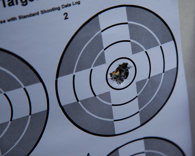

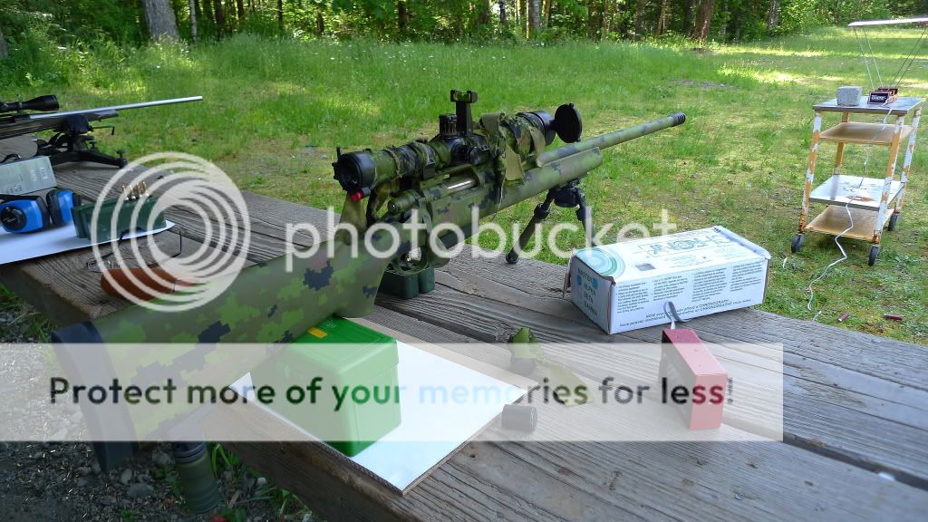

I have done a tonne to my 5R, both cosmetically and accurizing.
Besides the paint job
I put on a Farrel 20MOA Base
I had the action bedded
Replaced the trigger with a Timney at 1.5lb
I added lead weight to the buttstock
Added a defensive edge muzzle brake to control muzzle hop (recoil was already really light with the weight)
Added a accushot monopod and atlas bipod for prone shooting
Added a larger bolt knob to make it easier to work it and add a little torque
Added an extented internal mag box to fit a few more rounds
The results speak for themselves
100 yd target 10 April 12.jpg by ceriksson, on Flickr
Nice shooting Ceriksson but my 5r does it too:D
I believe all 5R are capable of that when the shooter does its part......;). They are amazing rifles out of the box...and like Ceriksson showed....this are not 3shots groups.... Who are easier to be tight....
