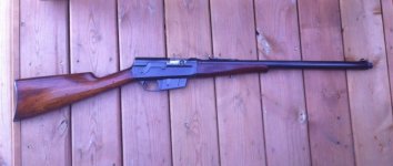

Here is the one I re-barrelled years ago.
This thread reminded me I hadn't marked the new calibre on it, so I finally got around to it today. On the outside, it's the only way you'd tell it's not as it left the factory.
