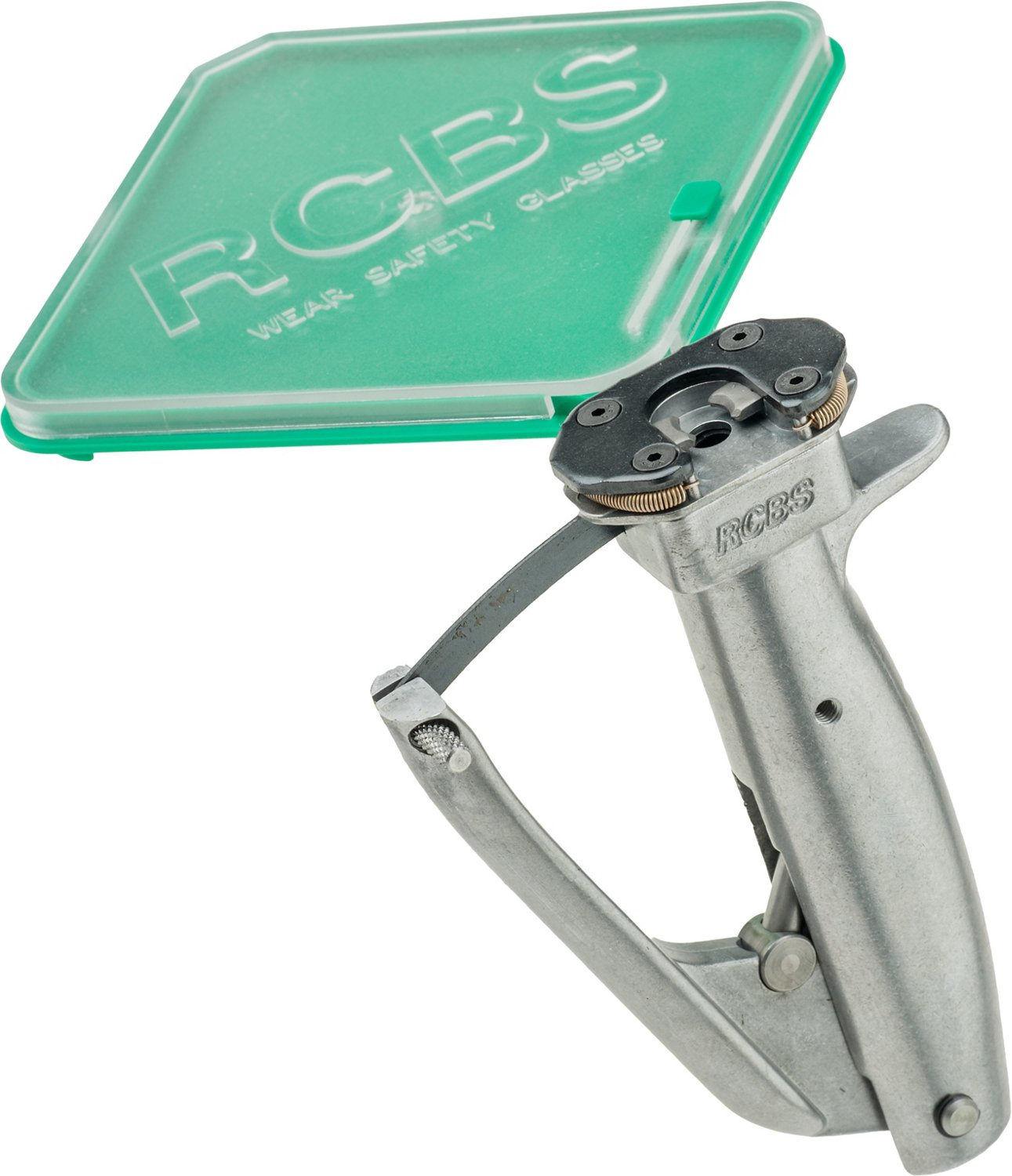

I used to own the Lee tool but broke it and replaced it with the RCBS one. The RCBS primer tool is much better in my opinion. I've never had any problems with it after seating thousands of primers.
You simply open the primer box, lay the tray over the open box, and turn the primer box over and you have 100 primers in the tray. A few taps on the tray and almost all of the primers even flip themselves right side up for priming. Flip the last few primers right side up, place the cover on the tray, and every squeeze of the handle seats a primer. The jaws are spring loaded so no shell holders are required. Best of all, you can feel every primer seat properly. I would gladly bet $100, that I can seat 100 primers quicker with this tool, than you can by tapping them in.
Is that a newer version in the picture? Mine is exactly the same but uses shell holders same as the press.
Op, reloading is a nice way to save some cash on ammo but you still need to invest in the proper tooling if you're going to do it right. Using reloading equipment that was barely acceptable when it was new (I have a box with one of the reloading kits you describe and it looks like it was made in the 40's or 50's) is probably not the best idea these days when there are so many better and safer products out there. I would rather use the primer seating attachment on my press than use a hammer and a steel rod to put them in. Spend the $40 on the right tool, you won't regret it once you start using it and see how much better it is. With the priming tools you can feel when the primer bottoms out and stop pressing rather than driving it with a hammer and slightly crushing it risking a primer detonation.

Except it doesn't require individual shell holders, and I find it much smoother, and more comfortable to operate.
It's a greatly improved version, not only because it doesn't require shell holders, but the mechanism doesn't fall apart when you go to change between primer sizes, and the rod is locked in place, so it can't fall out. It is also much smoother to operate than the older versions. It isn't cheap, but I have two, one stays set up for small primers, and one for large primers.

I may need to buy another one. I like the idea of not needing to swap shell holders. Smoother would also translate into a better feel for when the primer is fully seated :)

The newer RCBS is universal and works like a charm!
