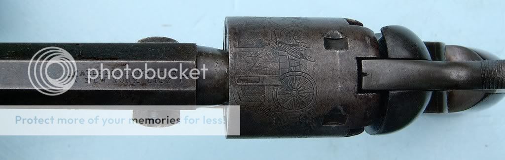

Two Colt revolvers that “may” have been private purchases and carried during the Civil War.
These two models are seen in many period photos carried by enlisted men.
Colt 1849 Pocket Model manufactured in 1855-- .31 caliber (5 shot).
Model 1862 Colt Police revolver, manufactured in early 1863---.36 Navy caliber.
David

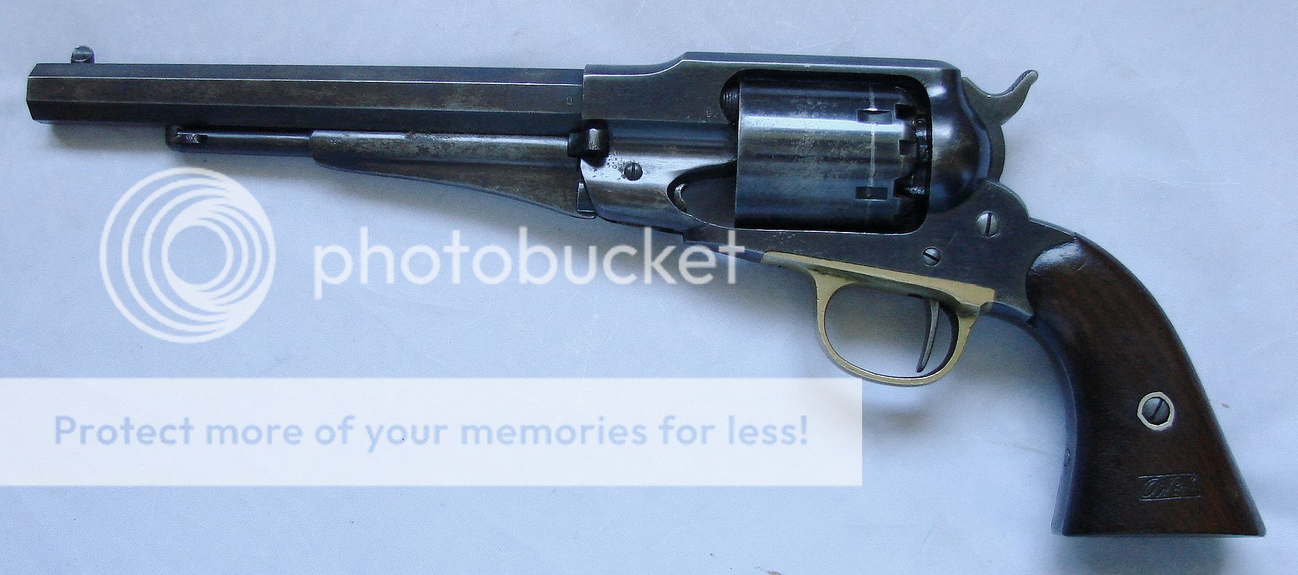

There is nothing loose on these guns....nor on the Remington and 1860 Colt shown above.
The Remington indexes like a precise vintage clock...if only modern guns felt like this.
