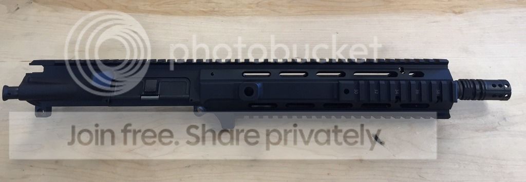

Remove barrel from IUR?
I made my own wrench.
10.5" with Smith Vortex G6A2 -SBV
Leverage is the key. Heat helps too.
I prefer a long breaker bar to knock the barrel nut loose.
The wrench I made is a simpler version of the Mega Arms wrench. No welds on my design.
4 prongs.
Milled flats matching your crowfoot wrench of choice.
If you do not have a geissele reaction rod, a good vise and a solid bench, you're better off sending it to a gunsmith.

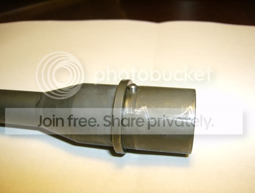

You also need the tooling and the skill to drill and pin your replacement barrel if you want to use the existing gas block and gas tube.
