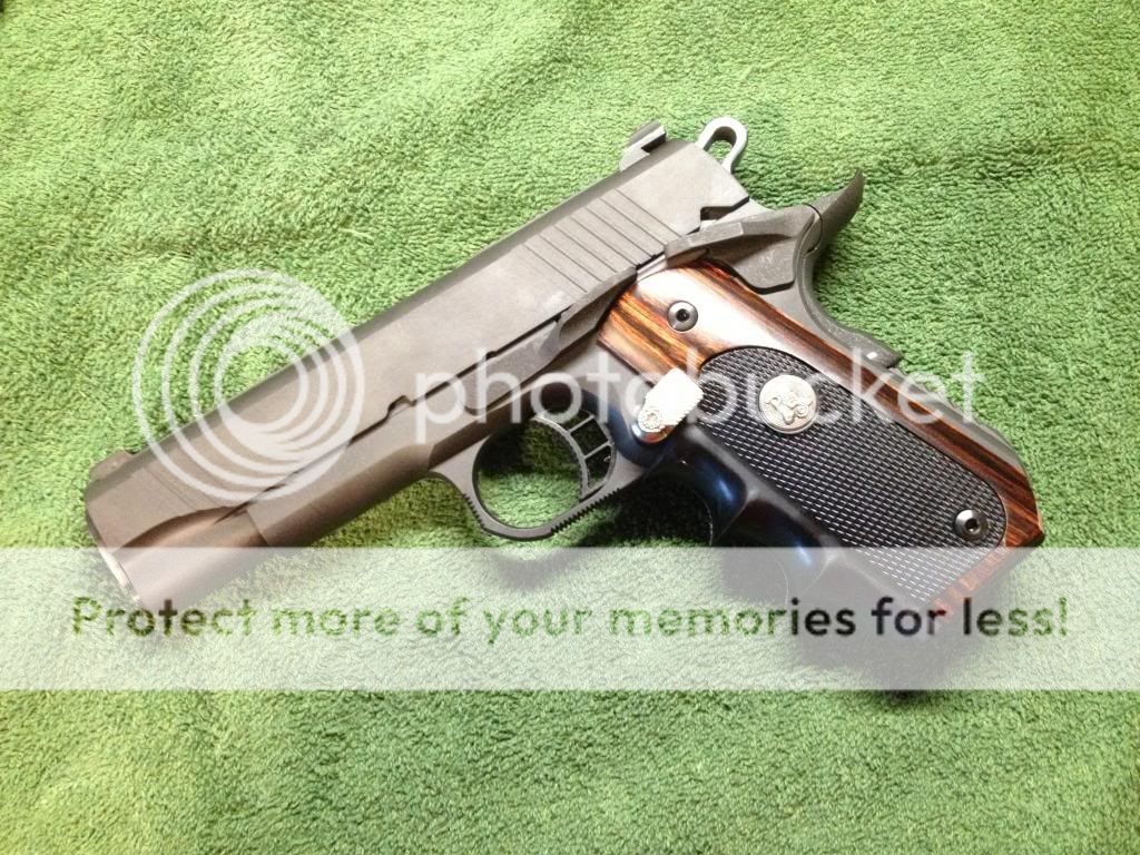

It's could be alot of work. I find different generations of Norcs are different so it doesn't help. The sights can be modified to fit usually. I did mine myself and fit it with night sights.
