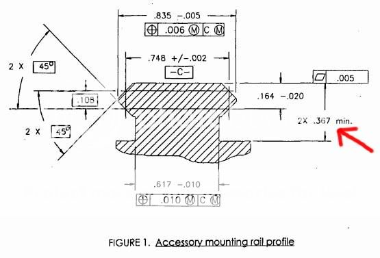

Also from the Nightforce website:
Our one-piece bases are machined to exact Picatinny Mil. Std. 1913 specification rail dimensions. This design allows the same scope to be used on several different rifles, always optimizing eye relief.
Ah, I see what you mean. The area just beneath the undercut should be taller. Most M1913 type rails get wide again at this point, probably for rigidity reasons.
