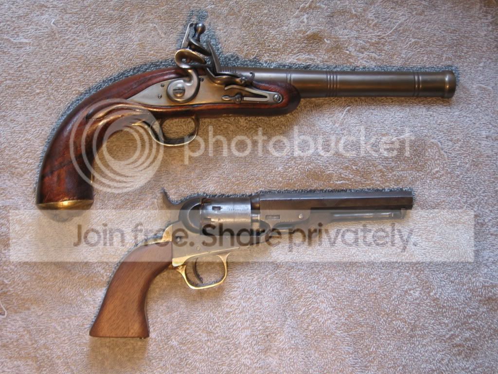

I just got a flint reproduction from the EE..... a smoothbore Queen Anne made by Pedersoli, haven't shot it yet. Hopefully there will be some black powder available for Back Powder day at the range June 5. Still looking for some ram rod wood and casting some .490 balls getting ready for the shoot.
This is the only picture that I have of the whole pistol at the moment also shown is a Colt Pocket 1849 which I am working on.
ramrod
i would suggest rather than wood get a 12" piece of .375 brass rod and make up one with a concave end to seat the ball. loads much easier and won't split and cause grief. my humble opinion
I hear that.
I have a .45 cal Pedersoli Pennsylvania. My buddy made one for me and I have yet to use the wooden rod. The brass rod inspires confidence. It's great when you get a ball stuck.
