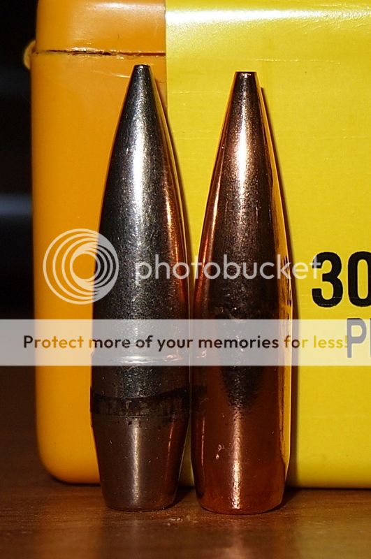

Everyone who reloads for the 7.5x55.
The original GP11 bullet diameter does measure .3075" at it's widest, near the boat tail, so not a problem using .308" diameter bullets.
The bullet tapers all the way to the widest diameter(bore riding). Near the case mouth / cannelure it measures .306"± which explains why so much erroneous information is out there that it is .306" diameter. They simple have not bothered to pull the bullets.
GP11 on left, 175gr Berger .308 on right.
You can see the taper.

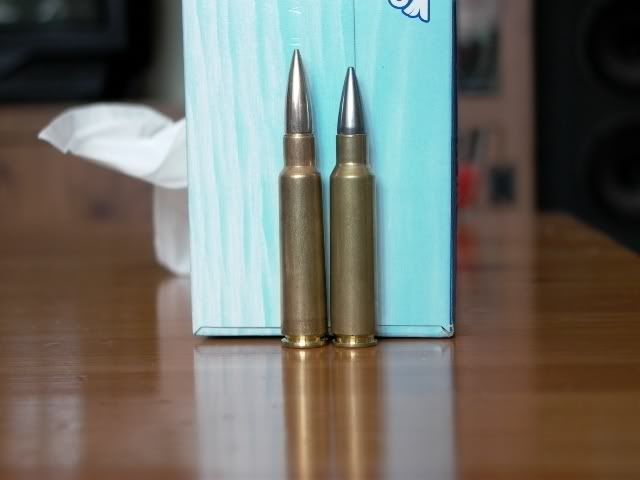

I like sharing this pic to show how much the body blows out in a K31. GP11 on the left, neck sized fire formed 284Win from my K31 on the right. Despite being short as hell, the 150gr Horn FMJ seated to the canalure shoot very well out to 300 for me. One of these days I'm going to get a proper 7.5x55 built on a long action Rem 700.
