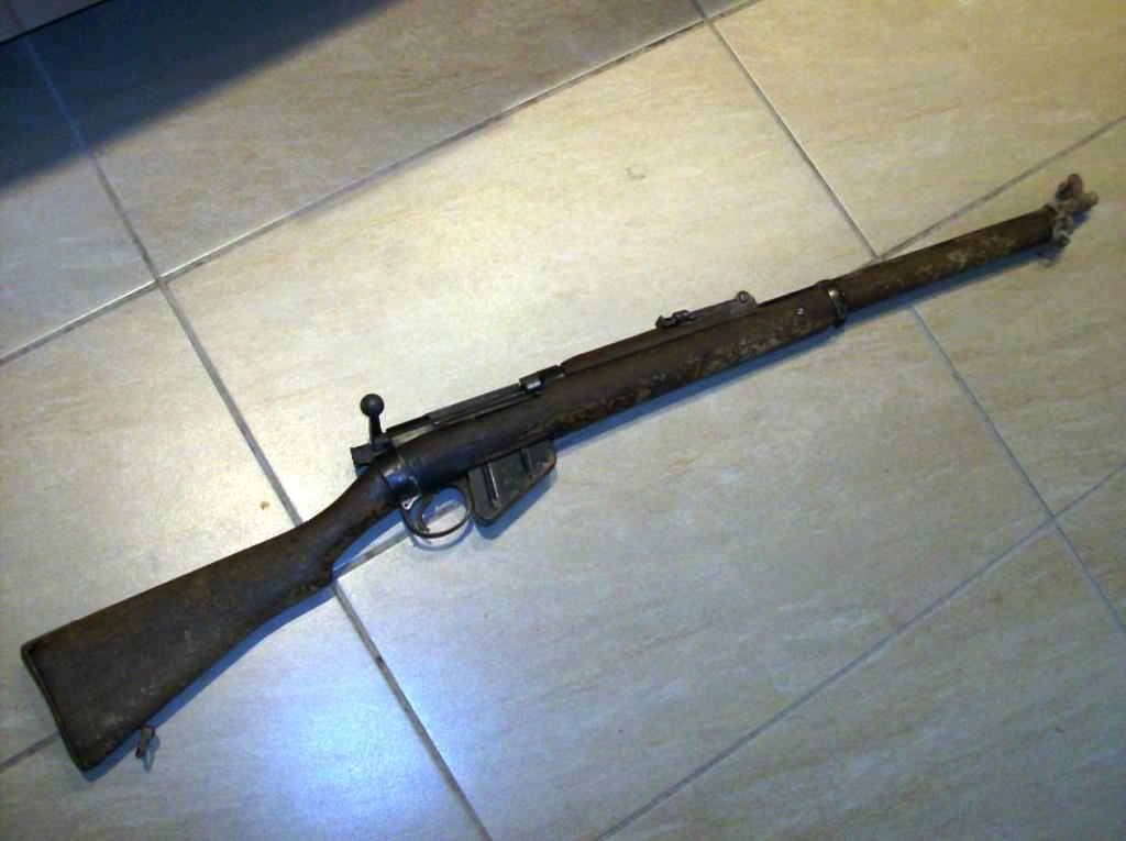

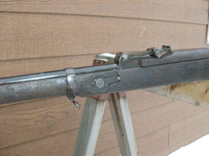

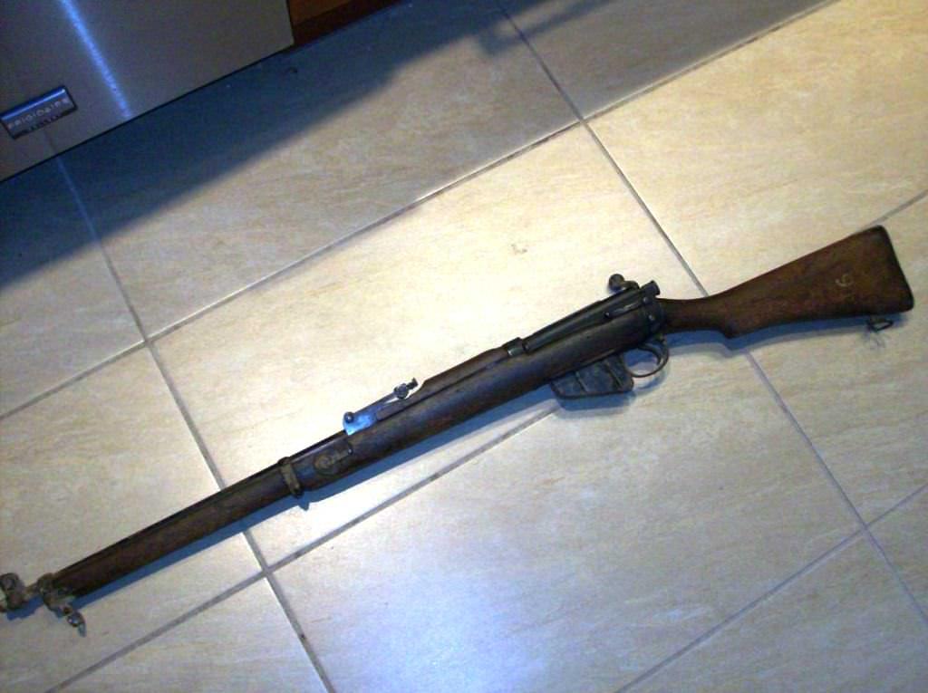

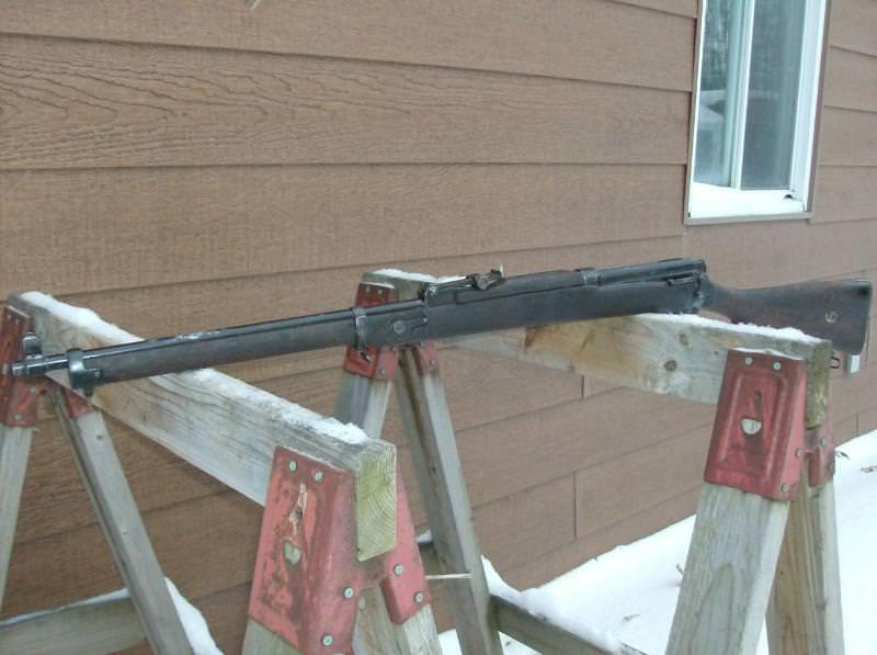

An acquaintance has trusted me with doing a bit of work on this not-too-common Lee Enfield. It was found, I am not kidding, in a creek in Ontario. Apparently there was a training air base not too far from this creek; so, it may explain why a Lee Enfield .22 trainer was found in this place.
Strangely enough, it's not as bad as one would think after spending God knows how many years under water.
My goal here will be to do as little as possible to the rifle, but to make sure rust is dealt with. I will clean the bore. Yes the intention is to make it fire again... There's even rifling in the bore.

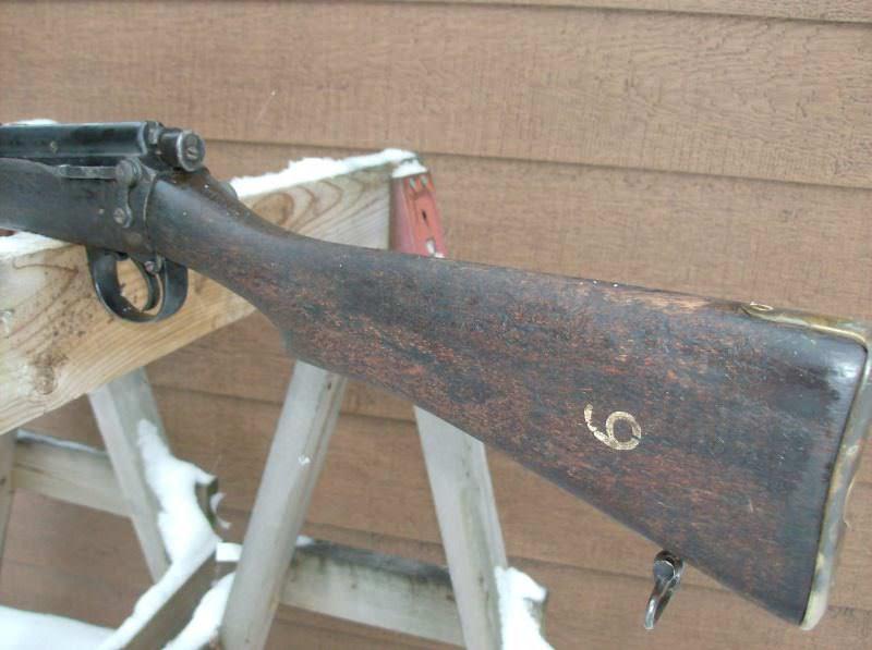

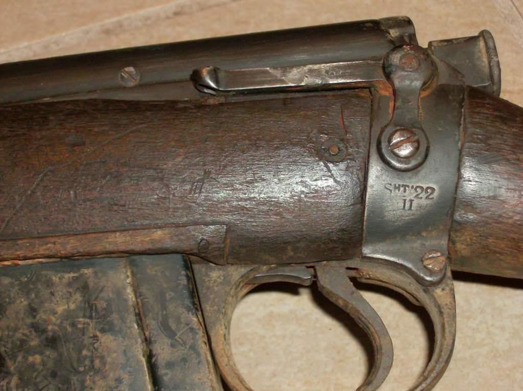

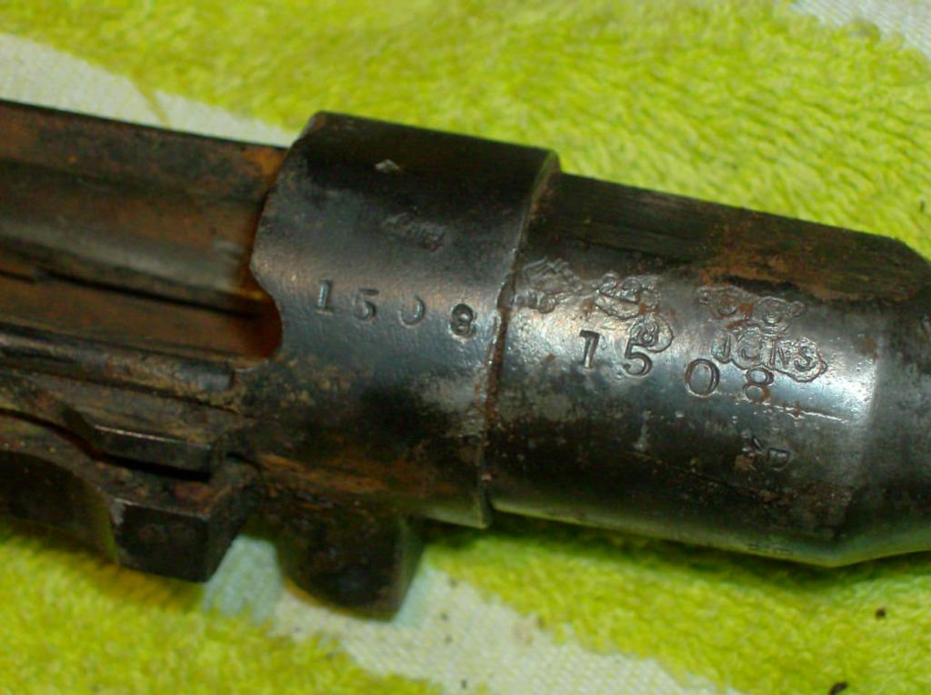

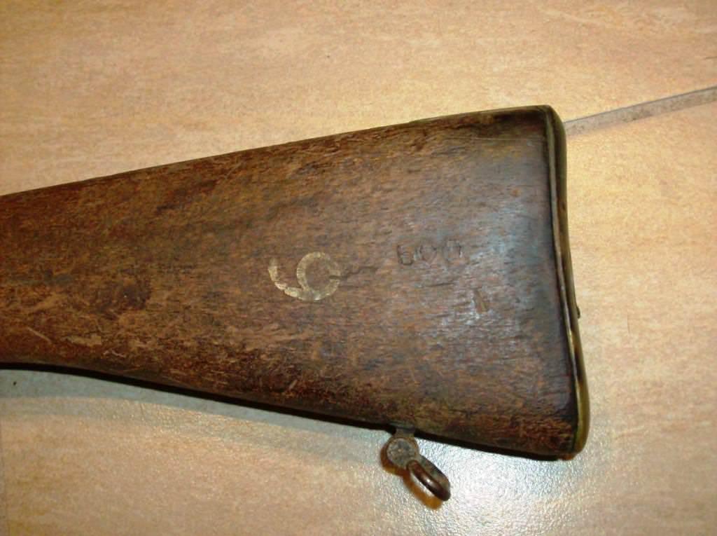

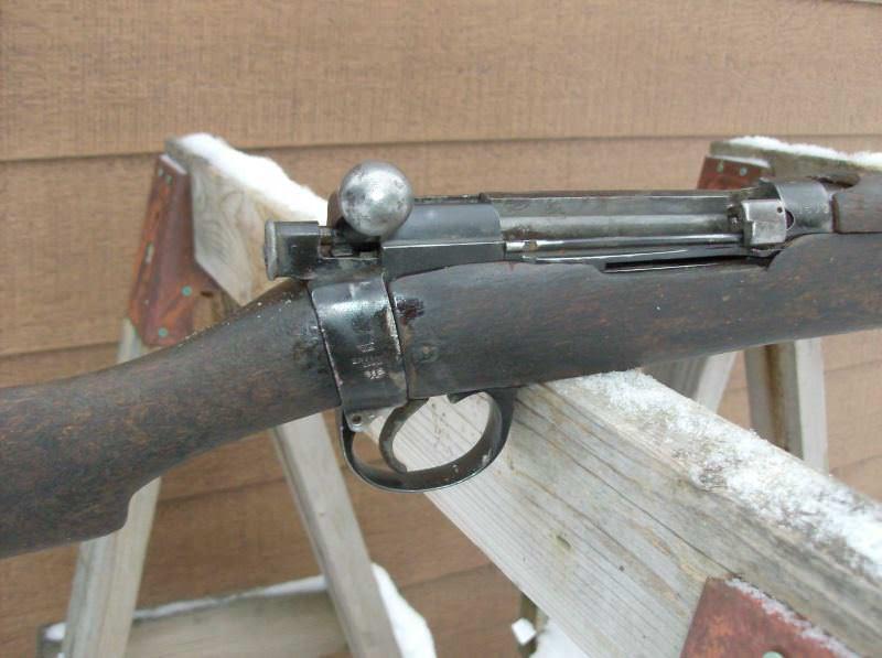

From what I know (that's very little) about this particular variation of .22 trainer, the rear handguard is wrong (it's a no1mk3-like handguard), and there should have been a rear sight guard there too. Rear sight leaf is non-matching, but the bolt does match the receiver.
I'm simply amazed.

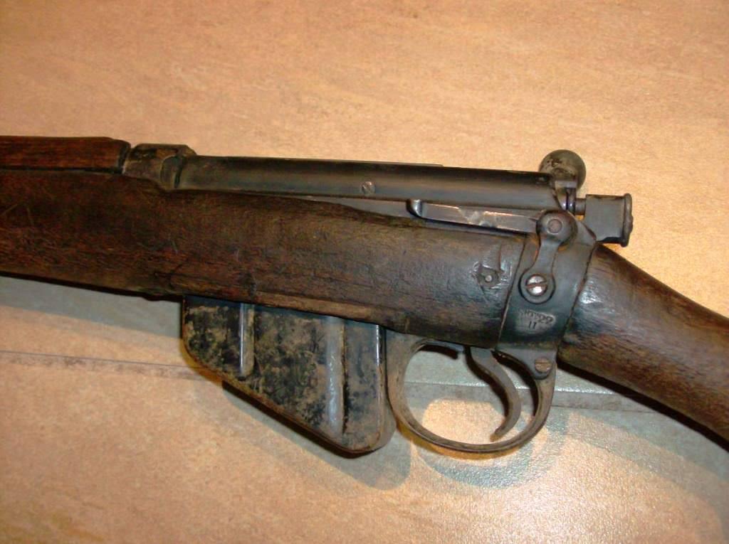

Ok, here's hoping screws will cooperate. Anxious to see how bad (or nice) the metal is under the wood!

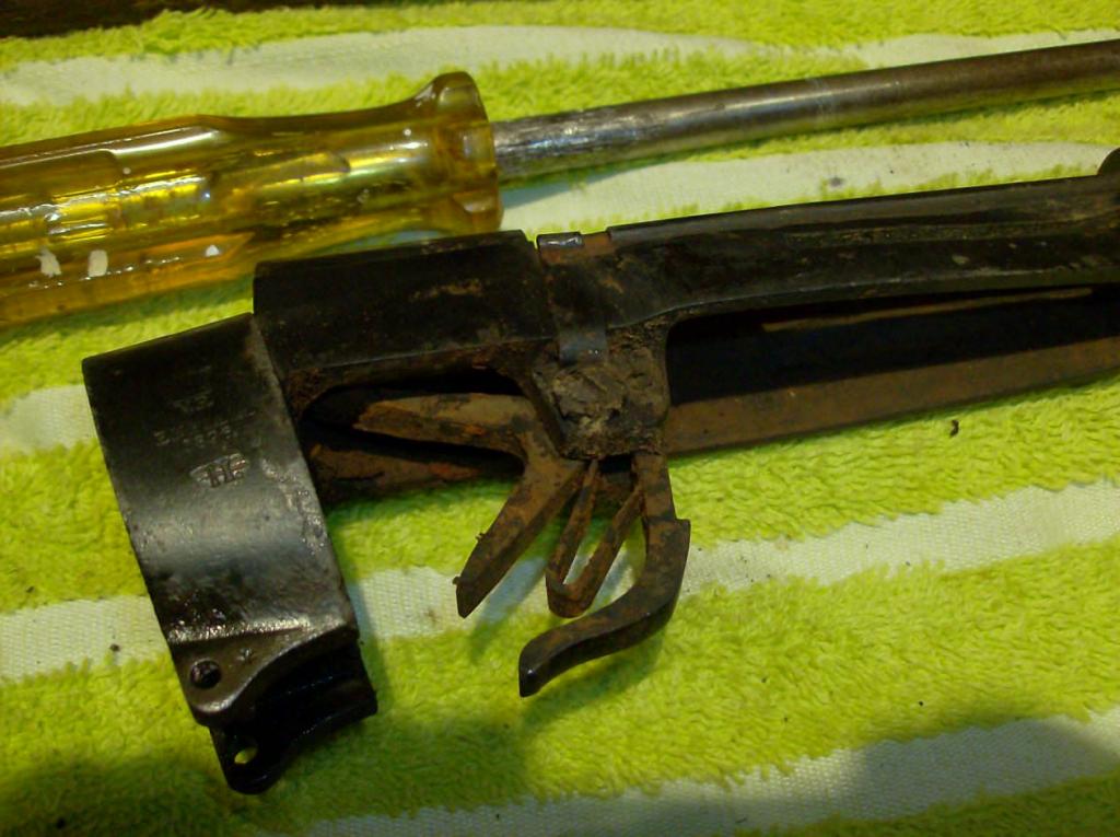

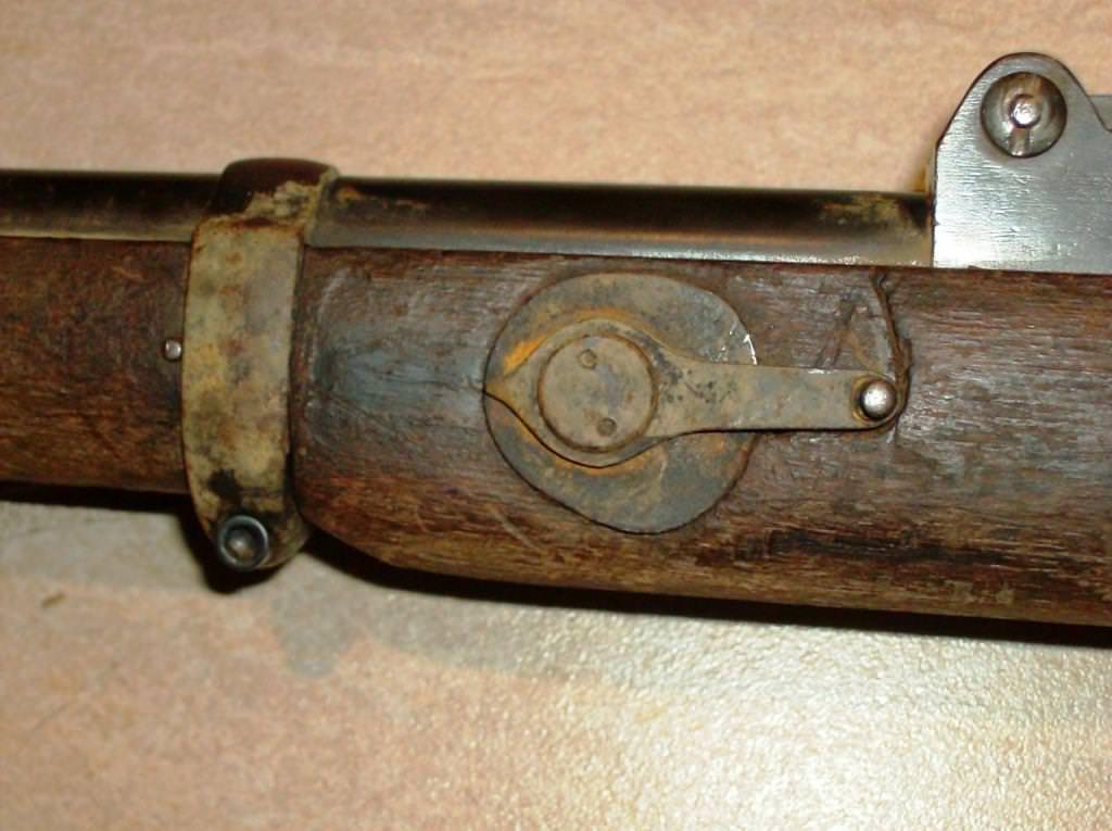

After letting Liquid Wrench seep into the screws thread, I carefully worked on them and to my delight, every screw did cooperate.

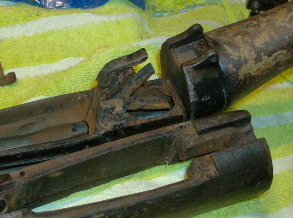

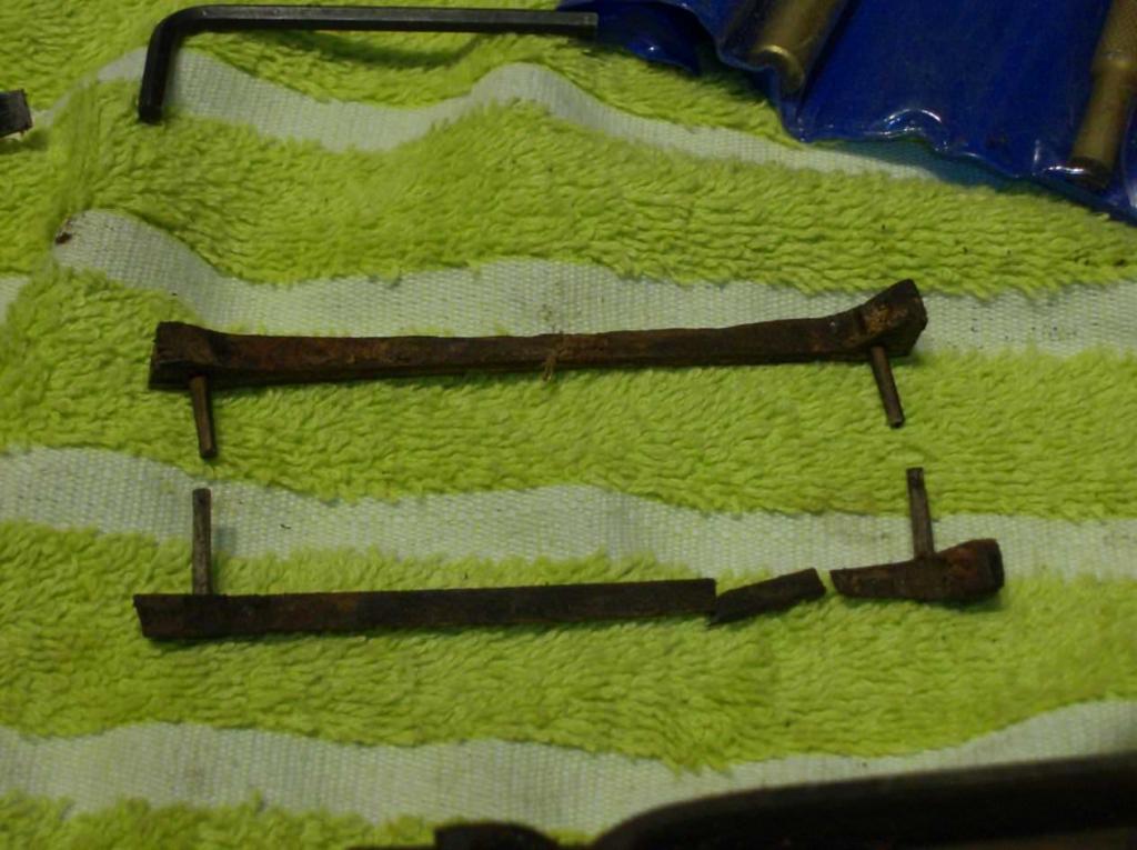

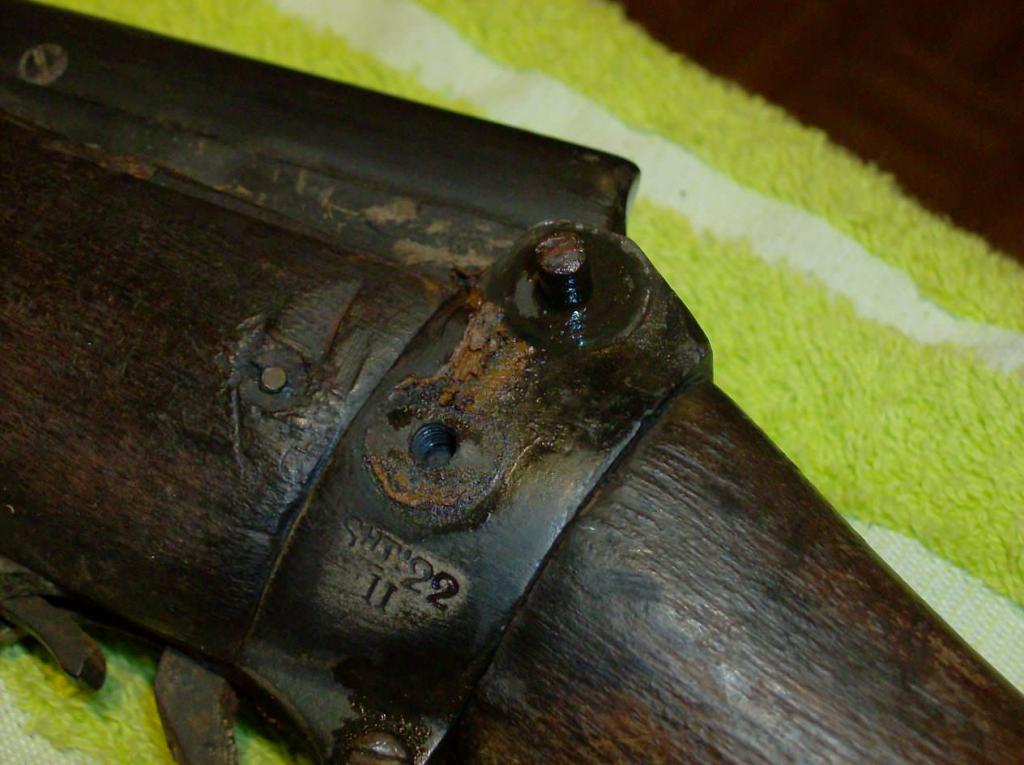

These two arsenal repairs on each side of the trigger guard came off but one did not survive (dang)
Even this came apart easily (ish). Both the screw and the pin came off without excessive force.

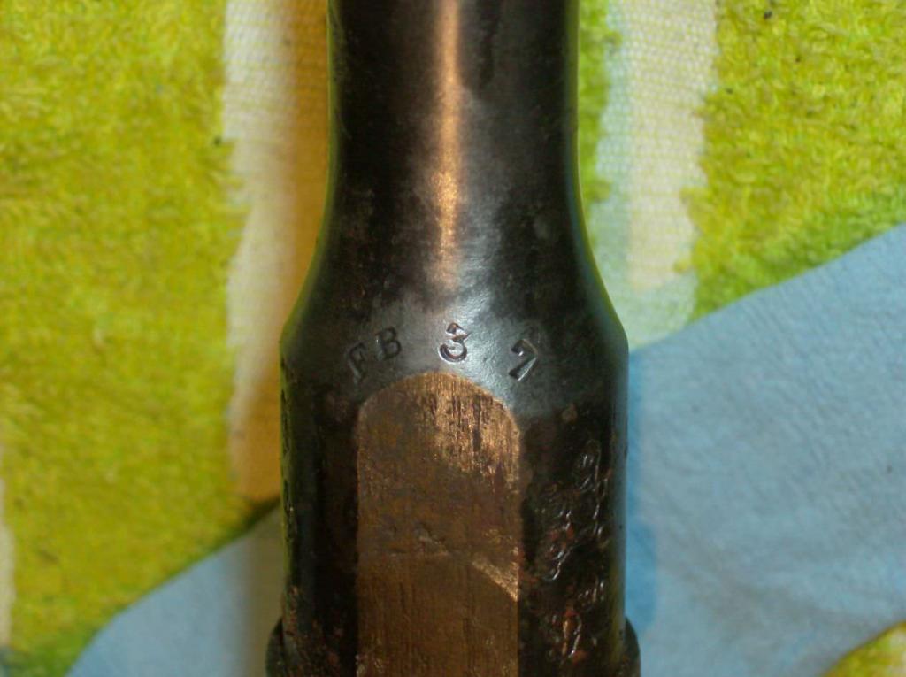

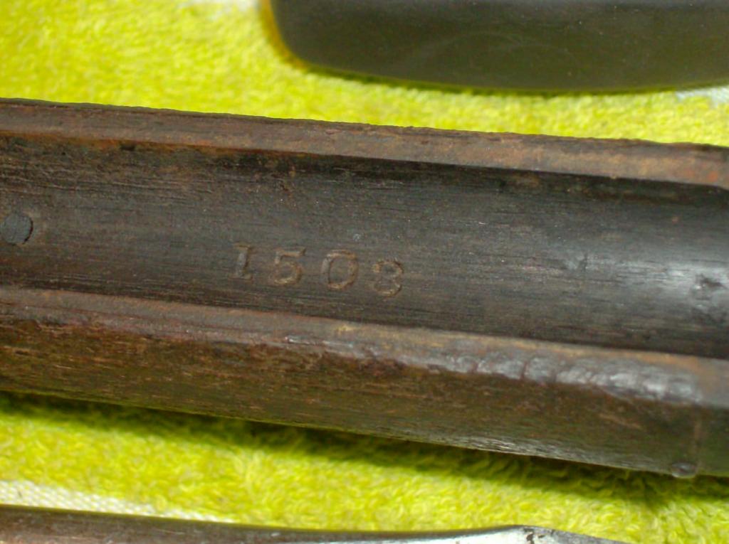

interestingly the forend is number matched, but stamped inside the barrel channel:
Not sure about the meaning of this;
So, off to a good start. Cleaning will begin sometime this week, or next weekend.

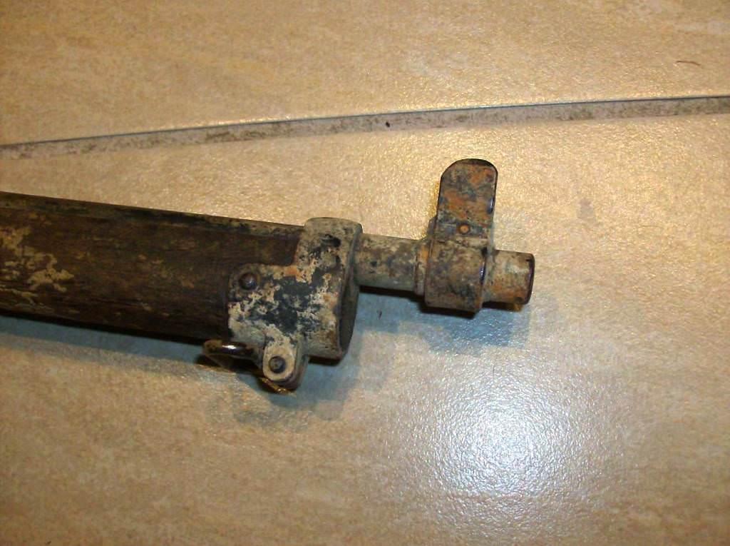

Things went rather well, but it took time. I cleaned each part individually. From the extractor retaining screw to the front volley sight arm, not forgetting the rear sight leaf spring retaining screw :) Everything was taken apart and cleaned.

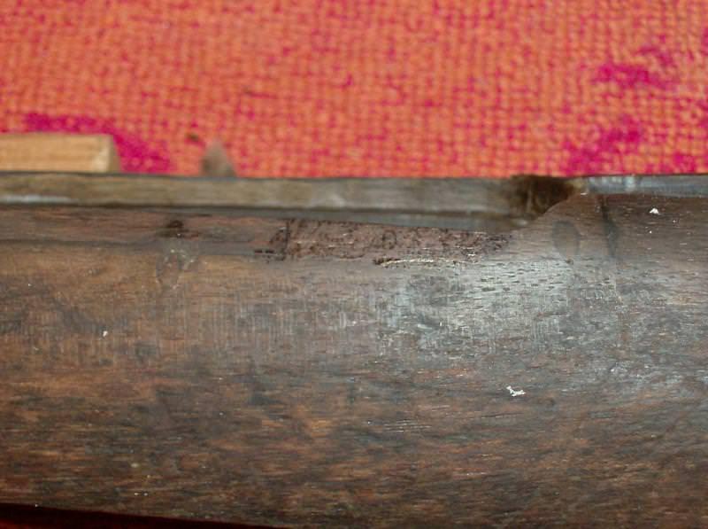

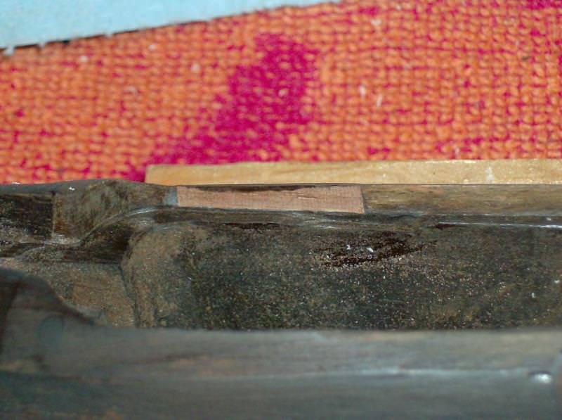

The repair of the forend, around the trigger guard, went well too. I had to replace one small piece (probably 1/2" long), but it's now solid enough and should last a few decades.
From inside:
From outside, stained:

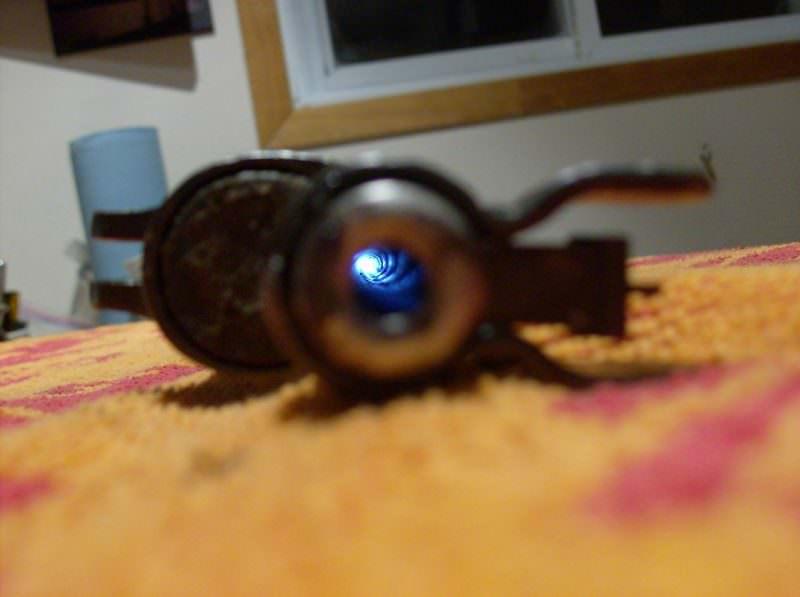

The bore was bad. Really bad. My normal cleaning rod (which usually goes through a .22 bore without a glitch) initially got stuck in the bore, because there wasn't enough clearance. So I began by plugging the muzzle and filling the bore with a de-rusting solution, which opened things up a bit. Then, I switched to bore cleaner (filled up the bore for a few hours as well). After a few hours of brushing, there was some rifling visible! And pitting. There is pitting in there, we can't really avoid this.

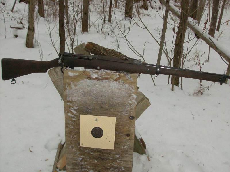

But, you know what? It shoots well enough to say: it's alive!

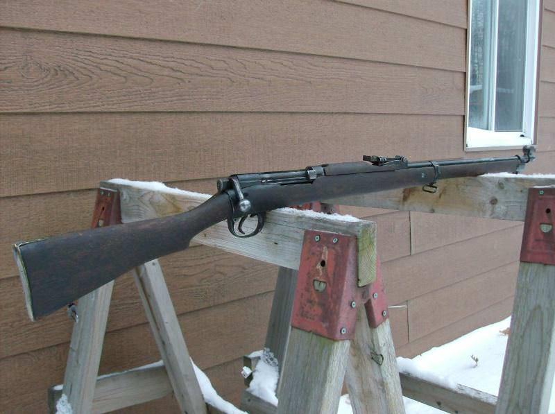

Further more, testing it in my backyard with CCI "quiet" .22 shorts (because neighbours and so forth), I am very happy to report that, at about 25 yards, we have rasonable grouping!
My "backyard range" (target is in the middle, behind the bird feeder - not the one on the right)
That was a great, fun project.
