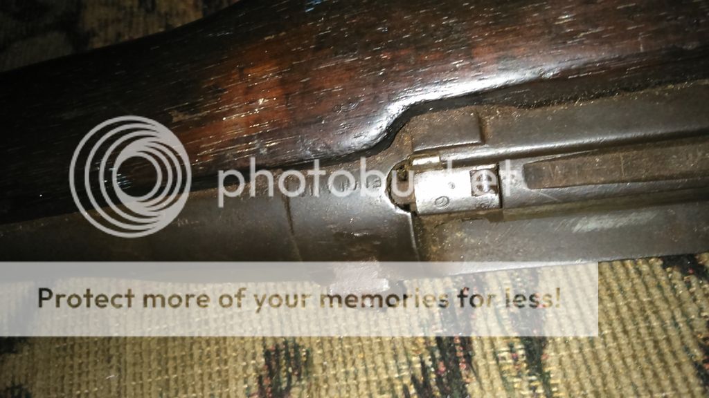

Hello all I have a number 1 mark 4 that's deal seen better days, I'm trying to restore it somewhat, its a beat up rifle used for seal hunting, it was sportarozed shortened stock sights messed up, no mag, bolts OK, the stock is loose, electrical tape everywhere, I will post some pictures when I get home, just wondering if anyone could tell me a parts list I need to at least make this rifle look close to original as I can
It is a Maltby #4 Mk1. (I know you know that). I don't see why it couldn't be brought back. The crappy rear sight install would be hidden by the new rear hand guard.

You need
complete rear sight
butt, forestock and top hand guards
barrel bands (3)
foresight guard, block and blade

That's in pretty rough shape, for $150-$200 you could get a sporter in 1000x better condition for a starting point if you want to do a restoration. Plus I think Maltby is kind of the least desirable manufacturer.
I wouldn't if it was mine.
A new handguard won't cover that hideous rear sight. The dovetail cut could be filled and peened over prior to refinishing and it wouldn't be as noticeable.
The butt stock looks pretty rough, but a few treatments with oven cleaner may make it prettier. The gurus frown on oven cleaner, but I still use it on wretched stocks. Unless you're very lucky, it will cost over $100 to get a replacement magazine and rear sight with the necessary bits. If the barrel is really nice, it could be worth $100 to someone and you could put it towards a sporter with a bit more life in it.
True, I was thinking just leave the rear dovetail alone, unless that's where the stock rear site went, over the bolt and action, was there something that went there some I saw had something I believe, and the reason I wanted to restore its anold rifle from a elder who was supposedly over in D Day with the forces, that's what I got told by a few of the rangers here and it came from them originally
Is that a rear sight or was it the mounting point for a claw type scope base before bubba threw away the scope and rings only to file a rough slot in the dovetail? Oh bubba!
Probably unlikely, but I have seen some pretty mysterious bubba work myself over time.
If the headspacing is okay and the bore is pristine, I don't see why you should not restore it. I would not care too much about it being a Maltby, who cares what other people think of it. Great fun to restore an LE. Thanks for posting the pics.
It's a rear sight fied way way down, and a slit sawed and filed, or just scraped in hahah
