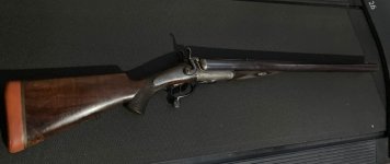

Over the years, I have acquired a few big guns.
Two gunsmith made doubles (one originally flint) using Brown Bess barrels. The one in the lower photo used a Long Land pattern buttplate.
A Belgian 8ga double.
A 10g percussion single waterfowler.
A full stocked no trigger guard Newfoundlander.
Now this one.

Here are some in that reside at my house,
top gun is a single 4 bore shotgun with a 42 1/2 inch barrel and is a 4 bore paper case gun, weights around 16 pounds
next was sold by Jukes Coulson and son and is english made, it is a 75 cal smooth bore and from what i have reserch was likely made for the Bores in Africa. they used a heavy stock gun and loaded from there horse when chasing big game. It has a 42 inch barrel also likey 14 pounds
the double is marked Tryon Philadelpha and is a 8 bore with 32 inch barrels and is also English made around 14 pounds
bottom gun is marked M Cadle and is a 4 bore, inside th elock it is marked Issac Hollis so i think they made the gun
The last gun is a 8 bore double rifle 3 1/2 inch case with 26 inch barrels and it weights in at 16 pound
