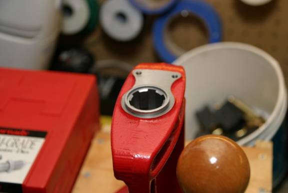

Just got back from WSS and fondled a press. The Crusher is very near identical in design as the RCBS. A slightly different casting where the handle mounts and then the top 7/8-14 threaded hole is directly into the casting, not steel sleeved like the RCBS which will make a difference.
