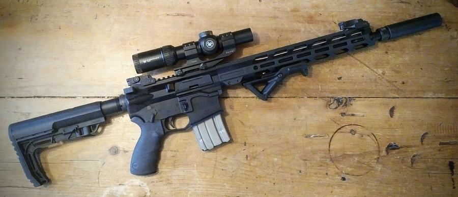

Got one today and can confirm it looks badass on my buddy Mike's ATRS MR with 18.6" barrel and MRA 13.5" handguard.
It was somewhat difficult to install. The threads aren't accessible from either end and at first I couldn't even get it started and thought for some reason it wasn't going to fit. But I eventually dug out my desk lamp with a magnifier on it to make sure I was lining up the threads squarely. It was tough to thread on by hand, and 5 or 6 times I took it off because I was worried I was cross-threading it on Mike's fancy expensive barrel, but in the end it was just very, very snug. Definitely adds heft to the business end though.
