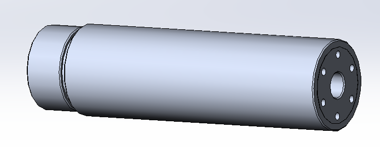

We did some spitballing on the weekend, this is a rough concept for a 1.5" diameter reverse-style fake can with linear compensator. The linear comp at the front is steel. The sleeve (aluminum) screws onto the rear of the linear comp (threads not depicted). Rear cap (also aluminum) is not essential but covers the gap, and is held in place with an o-ring. Total weight 8-9oz.

here's a first stab at it.
at 1.5" diameter anybody planning to recess this inside a handguard will need a big hallway to throw this hotdog down. Low-profile/lightweight handguards like Maple Ridge Armoury V1 would be a no-go but it would fit in AR-15 huge quadrails or 308 handguards like the MRA X1.
do we have any more votes for
- reverse style or extension style? (extension-style makes fit inside handguards a non-issue)
- linear comp or plain? If it's linear comp then I'd lean towards making it steel to prevent erosion and then you're looking at a 1 pound muzzle device instead of half pound
