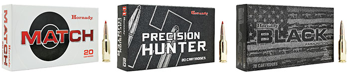

Hornady Match, Hornady Precision Hunter, Hornady Black

At the bench, the 108-gr. load averaged 2633 f.p.s. through my chronograph, no less from the Resolute’s 16", 1:7.5"-twist barrel. The 103-gr. Precision Hunter load recorded a 2671 f.p.s. average velocity, which, of course, is well below its 2800 f.p.s. touted velocity with a 24" barrel—but still impressive for a carbine. This results in 1,632 ft.-lbs. of muzzle energy and more than 1,000 at 300 yds. At 1,000 yds., it results in 368 ft.-lbs. of energy with 378" inches of drop and 93" inches of 10-m.p.h., 90-degree deflection. According to Hornady, real-world numbers with a 24" barrel at the muzzle will likely be around 2740 f.p.s
