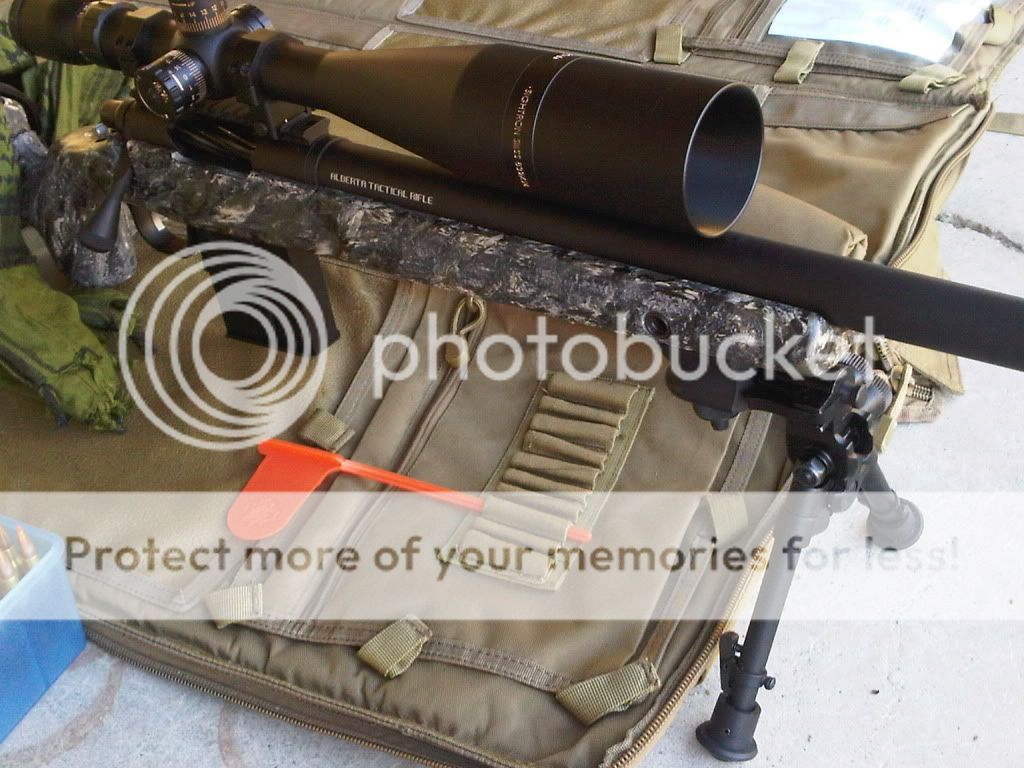

So without further ado let's review what we have:
Stiller 'Predator' action with 20 MOA rail
Rock Creek 24" 1:10 barrel with M40 contour
McM A5 stock with 3-way butt and integral cheek piece
ATRS bottom metal using (of course) AI mags
Jewel trigger
Anschutz rail
Versapod Bipod + Battle Pack
Blackhawk cheekpiece
All metal Cerakoted matte black

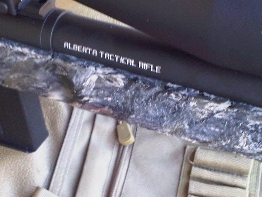

The McM stock is one of my favorite types of stock and I chose a green, and black marbled sort of colour as my Tac-Ord is in desert camo ( summer and winter rifles eh ? ). Naturally, I chose the McM A5 but I hate the saddle so many have - I think it looks cheap - and is a fault I found with the Coyote and with my Tac-Ord custom so I wanted the integral cheekpiece. Stupid, I know - the darn thing wears a Blackhawk cheekpiece anyway so you can't even tell but, hey it is what I wanted :)

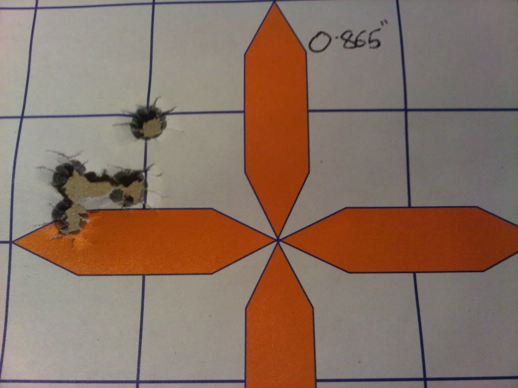

After a couple of rounds of the crappy but cheap AE to get on paper, I shot at 100m, and 200m Shooting from the prone off bipod and with little wind I was happy with the results. I fired 40 odd rounds without cleaning and without a particular break in ( "just shoot it" according to Rock Creek ).
I found the rifle shot both 168g loads well ( under half-minute ) at 100m and I used the 175g loads at 200m where the results were also sub half-minute. The 190's were just either side of 1 MOA at 200m which was disappointing - I feel the Sierra Accuracy Load needs a bit more ooomph so will experiment further with that.
I also took a few shots offhand to see if this relatively heavy (16lbs or so ) rifle could be operated well-enough by me in this position - hitting a 200m gong was easily doable.
As expected with a heavy rifle, recoil was nothing to worry about either offhand or from the prone.
At 100m
At 200m - note the user error !
More user errors ?
