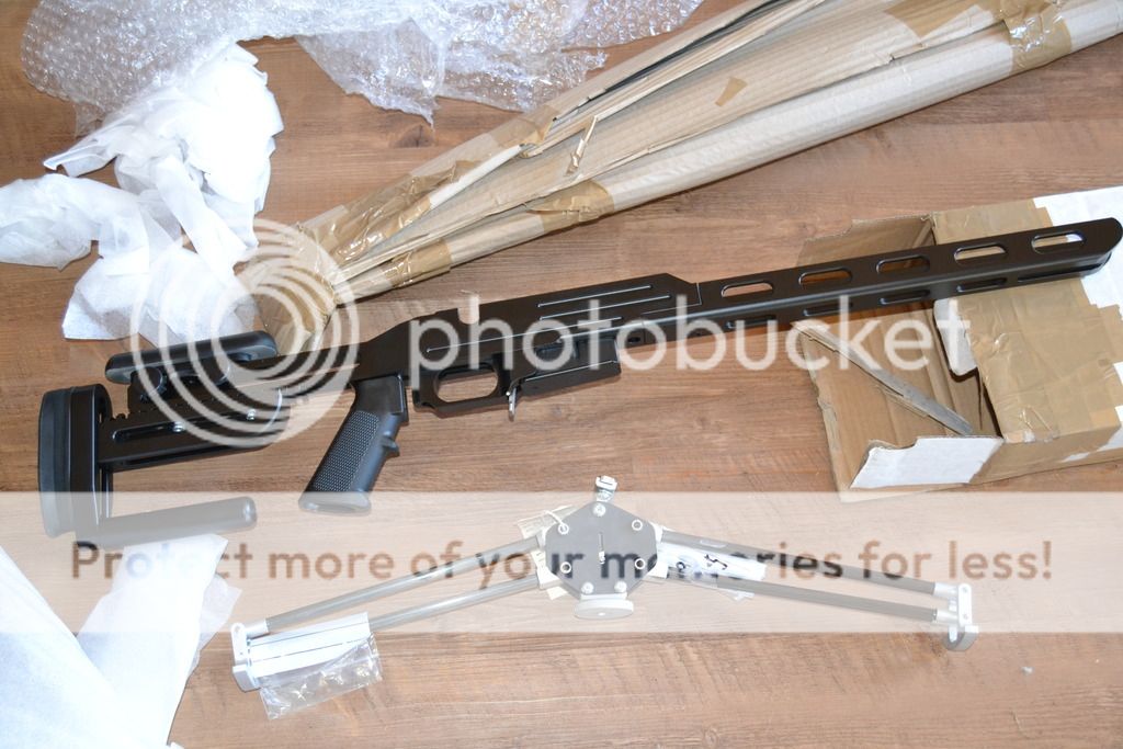

As always, Wolverine were great to deal with. No sooner than I say OK does a package arrive at my house. Though the chassis arrived fully assembled I took it apart and re-assembled it to make sure all the bits and pieces fit together properly and to look carefully at the machining. I am happy to say that assembly was easy ( of course, I'd done it once before with the identical chassis from Extreme ) and the machining was perfect. All aluminum with a perfectly even finish this is clearly a quality piece of gear as one would expect from a well-established company with a very good record of making quality products.
As It Arrived:

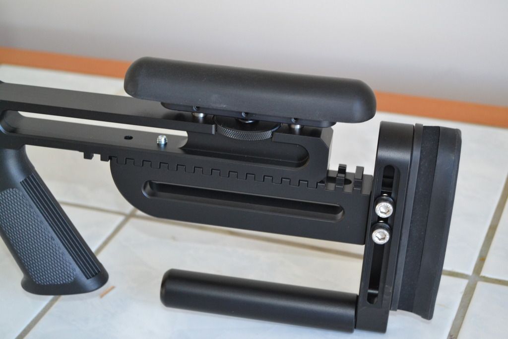

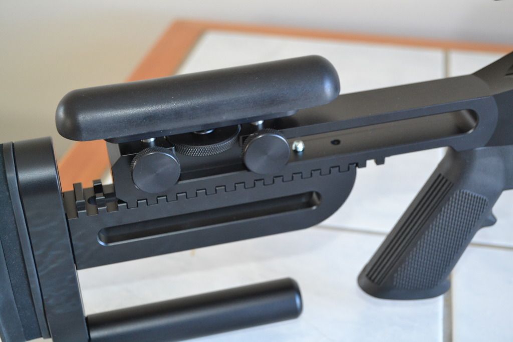

The chassis allows for LOP and cheek height adjustments though to adjust the LOP one is going to have to break out the Allen wrenches and this isn't really an 'in the field' job.
Adjustable But With Tools:
While the Dolphin Chassis is supplied with a basic AR grip it is easy to install the grip of choice and make it more 'yours' but, other than switching out the grip, that's about it for the ability to customize or personalize your chassis.

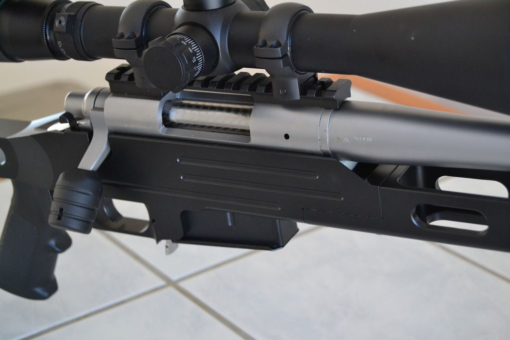

I don't know what prevented my test rifle fitting into the chassis supplied by Extreme but I am pleased that in the case of Dolphin the chassis really did fit as advertised.

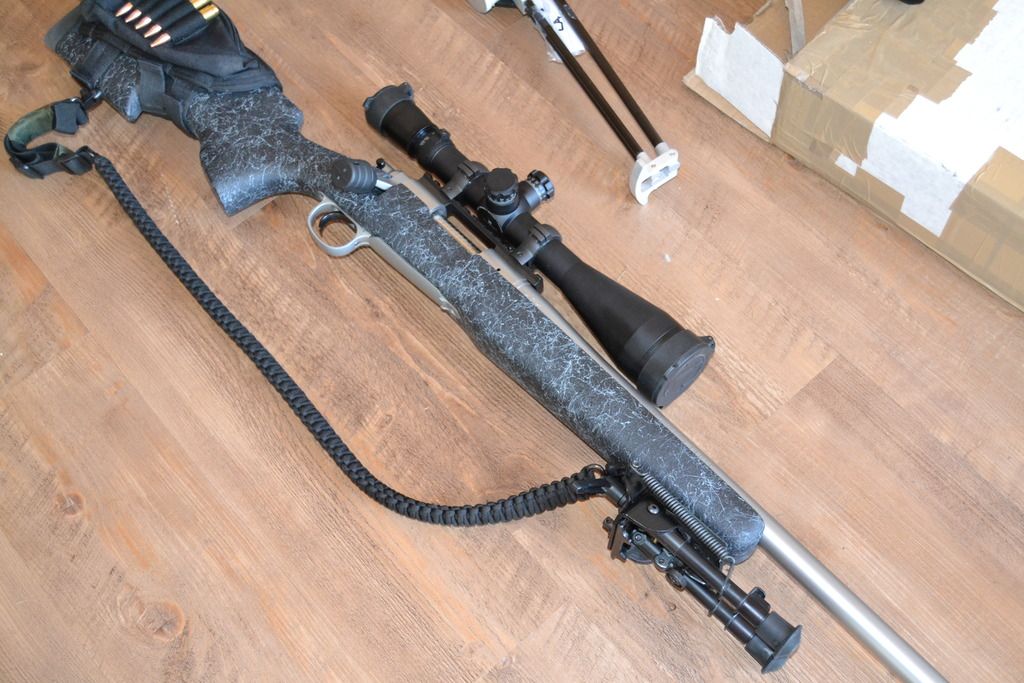

My Test Mule:
Fitted:

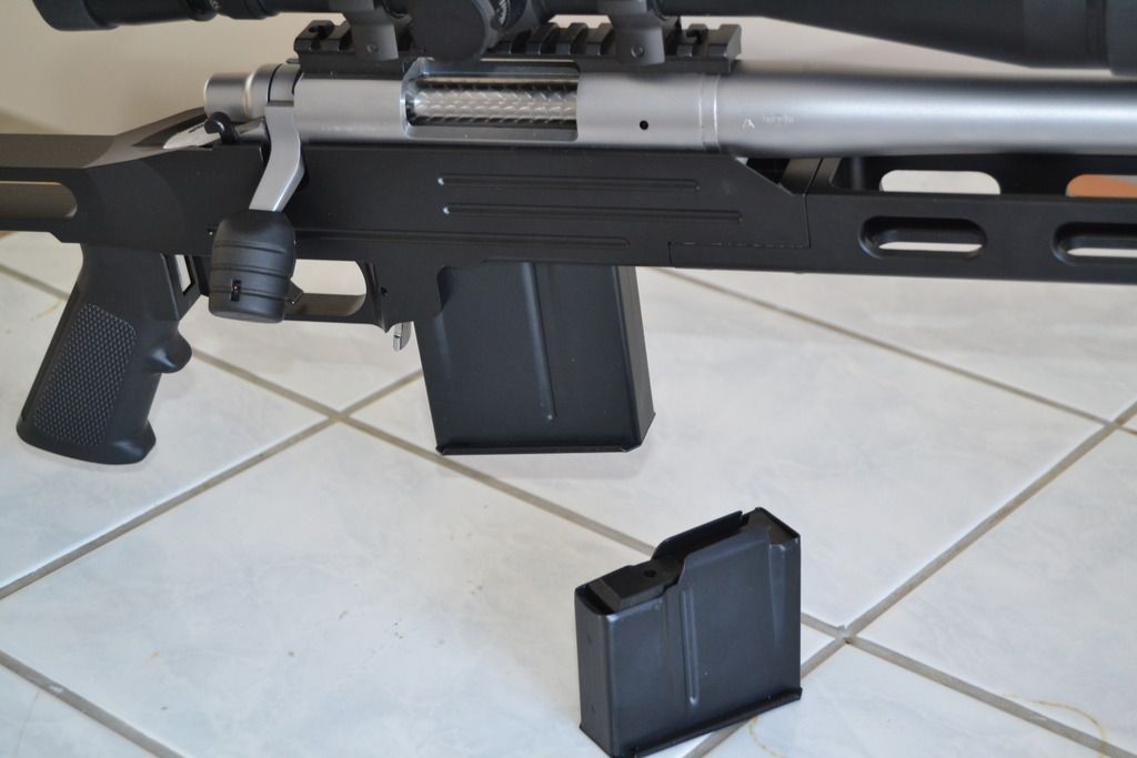

Cinched down nice and tight, the rifle sat in the Dolphin chassis quite perfectly and the supplied AICS 5 round mag fit tight with no annoying wiggle. An 'Accurate Mag' clone and a real AICS ten rounder fit equally well and, as expected, a number of dummy rounds cycled perfectly through all magazines with no binding or other issues.
Mags Fit Perfectly:

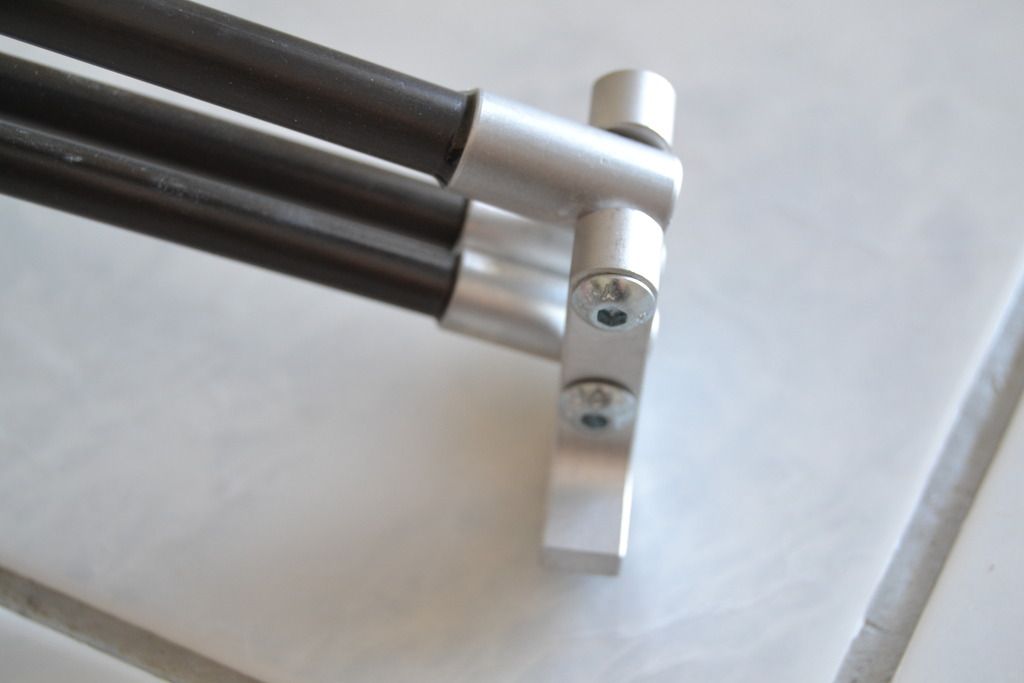

The Trakker II bipod that came with the chassis was immediately appealing as it was both nice and light and clearly well-constructed with no machining marks or other evidence of rushed or shoddy workmanship. Of course every bipod is an inherent compromise between weight, steadiness, size, easy of deployment, ease of adjustment and price and no single bipod will suit every person or, indeed, every application and so a prospective purchaser must decide what features are most important to him or her and go from there.
Attachment to the Dolphin chassis was easy and accomplished via the supplied Anshutz type rail. When attached the rifle felt very solid and I was easily able to make the usual adjustments.
Ski Pod type feet feel perfect for shooting off relatively flat surfaces. More ideal for F Class than Tactical games of course.

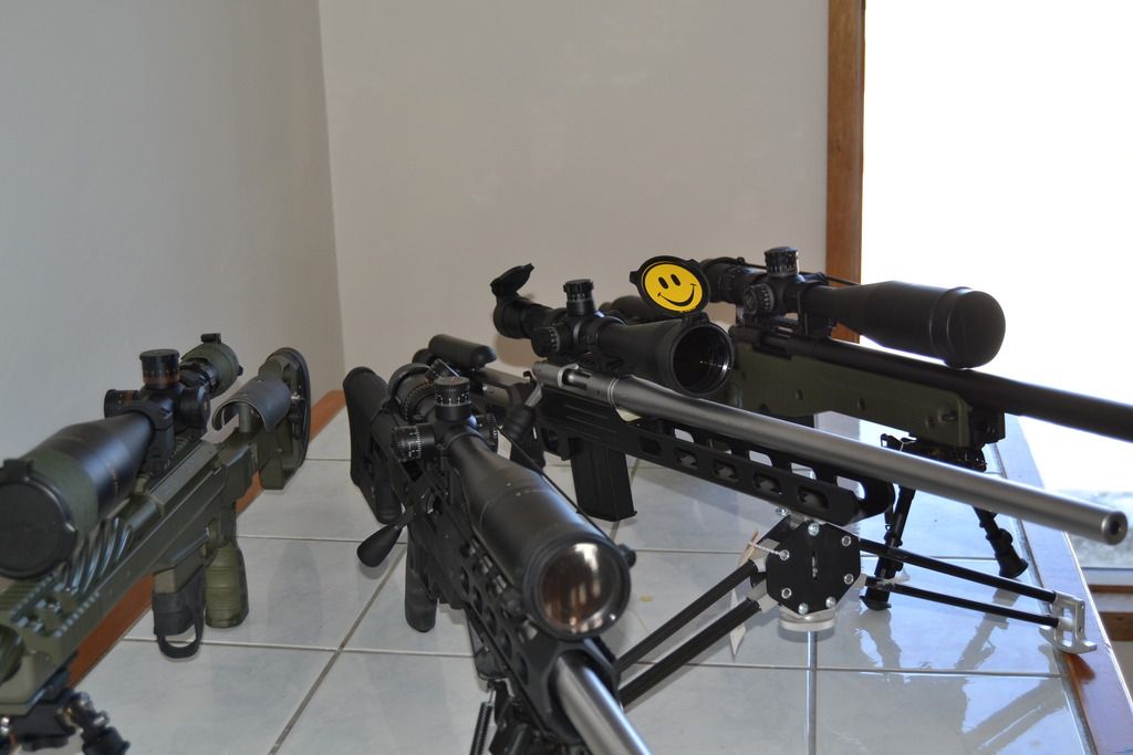

Sitting Amongst Some Tactical-Type Rifles:
In the field the chassis and bipod worked very well. and, in particular I thought the bipod to be so good that it really ought to be one of the ones under consideration for any F-Classer worried about weight ( and, in that game, who isn't ).
