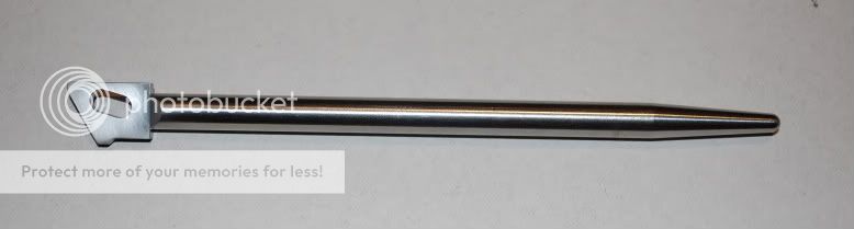

I just received the newly mfg'ed Op Rod Spring Guide by Rauch Tactical or suprathepeg... you know.. the dealer that brings you all that cool CZ or VZ58 (sp?) stuff?
The dimensions are perfect! They fit both Norinco M14 spring and USGI M14 Spring ... no worries, you will be well served with either spring you choose to employ in your M14. Those of you who are not aware, the Norc M14 Op Rod Spring (recoil spring) is about 0.5 inch shorter and a few thou tighter in diameter from the USGI spring.
Does one need a USGI spring? Only if you don't want yer dic...(you knew that was coming....) Nah, save yer money and use the Norc spring... I know I am...

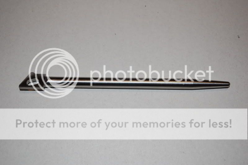

Take a look at the pics.... The Marstar.ca version is identical but with a few leftover machining marks that don't take away from the intended performance. The Rauch Tactical (suprathepeg) version is finely finished without any burrs or sharp edges! Way cool...
Now have a look at the other side:
Dimension wise, both the Marstar.ca version and the Rauch Tactical will fit perfectly into the slot of your M14. No hangups, no nasty surprises from both units. I deliberately left a USGI from a TRW sourced M14 for you to compare. Rauch Tactical certainly did their homework here.
Both Marstar.ca and Rauch guides are machined from ONE piece stainless steel which means that there are no welds to break on you during a rapid fire (competition shooters, take note) string. I've seen the Geneseo, Illinois versions break during our NRA High Power matches 20 years ago.... :rolleyes:
I have shot my M14 with both stainless op rod spring guides and did not experience any failures to fire, extract, or insert/remove my 5/20 magazines. :D Life is good. The Rauch Tac version works exactly as he (suprathepeg) says it will and it's first rate quality.
