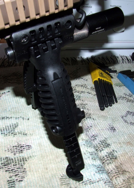

Here's a quick pic:
Notice the tools in the background. Why would I have tools out?
Because the damned thing just broke while I was putting it away. It's been used for one shoot and enough practise to get comfortable with it.

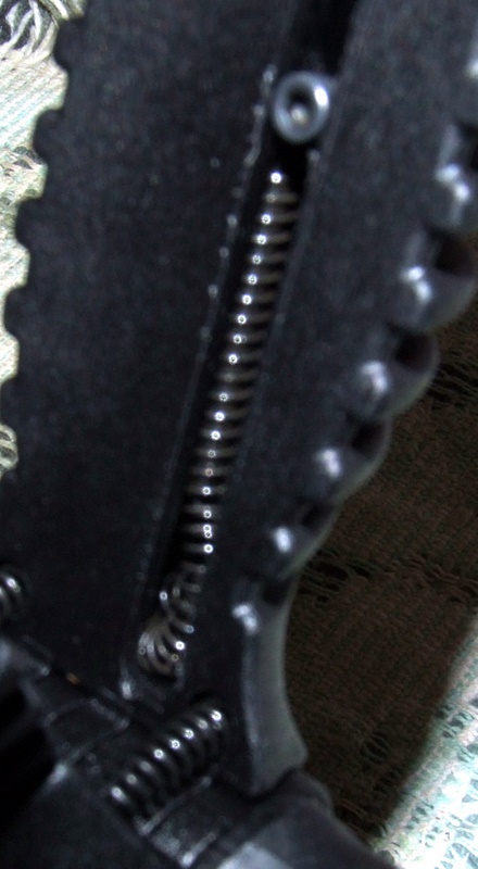

Notice the kinked spring:
Nothing lasts forever. Did I just get a rare lemon?

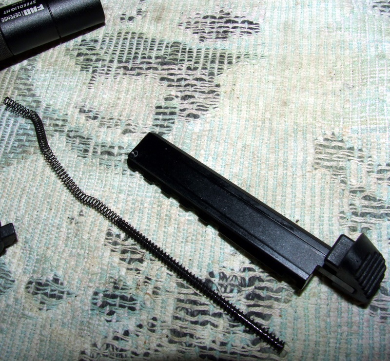

In the next picture you'll see the spring and guiderod. The guiderod is supposed to be pressed into the body of the unit and remain stationary as the leg moves in and out. In my case, the guiderod fell out, allowing the spring to kink.
Why did it fall out? Because it's pressed about 1/16" into plastic, with no positive retention, not even knurling. I popped the second one out by hand with almost no resistance. Every time you put your gun down hard on the bipod, those little rods will want to move in and eventually exit their mooring.
Conclusion: nice toy. Don't bet your life on it. Or a competitive match.

In a word, no. The light is activated by a pushbutton at the back - visible in the first pic. This attaches to a small rod that travels through the mount and pushes on a nylon cup. The cup holds an aluminum slug that, when pushed forward, completes the electrical circuit to turn the light on. It works "okay": often the connection is weak and the light dim until you push again, harder. You have to push pretty hard to keep the connection going.
The light proper has o-rings on the body to keep water out - but the `small rod` mentioned above has no water-repelling features. After a day in the rain some water got into the light body, behind the nylon cup, having travelled along the `small rod`. It`s a close-tolerance cup, so the water got no further - but nylon is hygroscopic (it absorbs water, albeit gradually). The day after the rain, the cup had swelled enough - about .017`` - to jam up. Full disassembly followed by several days of drying over a mild heat source shrunk the cup to its original size, and everything worked fine again. But it should have worked fine without that, given that it is sold as `waterproof`.
