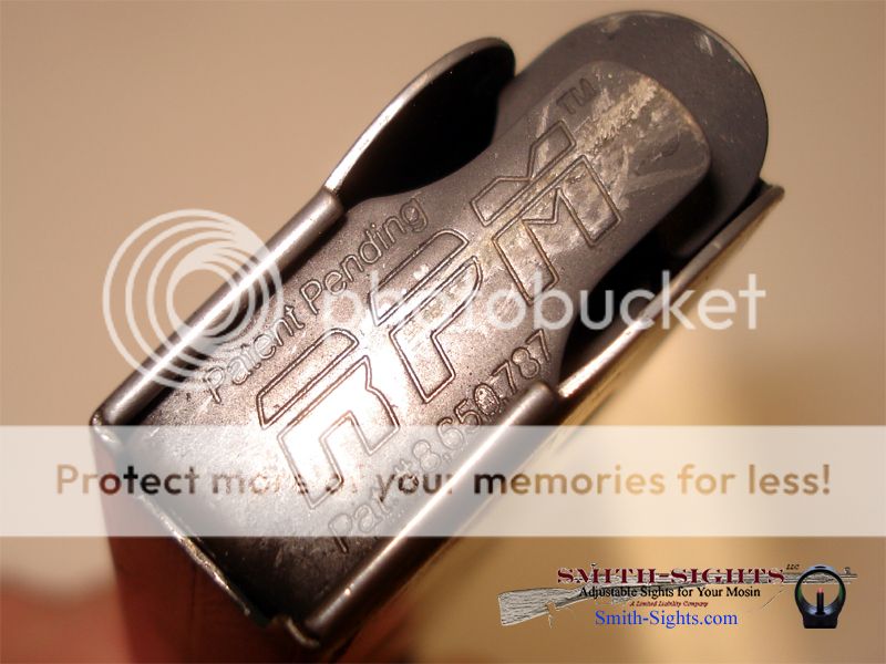

The new Chip McCormick Railed Power Mag is an excellent design, addressing several key issues which have plagued greater-than-seven-round 1911 magazines since they were first tried.
Among the most significant changes, the feed lips are folded. McCormick chooses to call these "rails". Whatever the name, they provide unparalleled toughness and the ability to slam the full magazine home on an open slide without the fear of spreading the feed lips.
This allows the other two other innovations, those being the full-power mag spring and full-length follower leg.

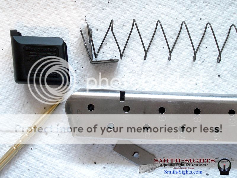

I took the opportunity to detail strip my 1911, and then moved on to the magazine:

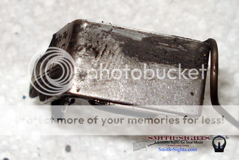

I noticed uneven contact of the follower with the mag tube:
Upon cleaning, the issue became obvious:
The follower was bent!

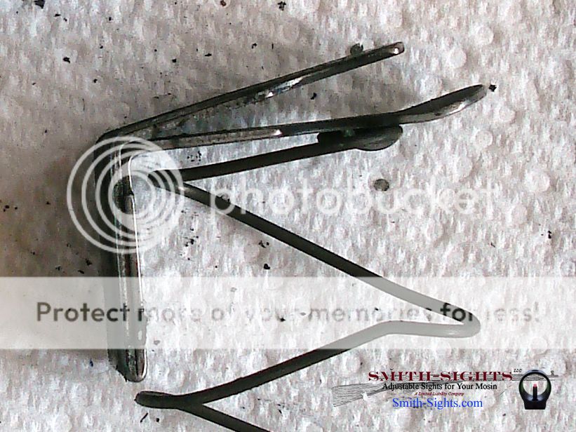

I then reinstalled the RPM follower and took a picture so that I could easily see where it was dragging:
Here I should note that McCormick would have made this right. However, this was a new toy and besides, I like fixing things myself. I bent it to where it should have been:

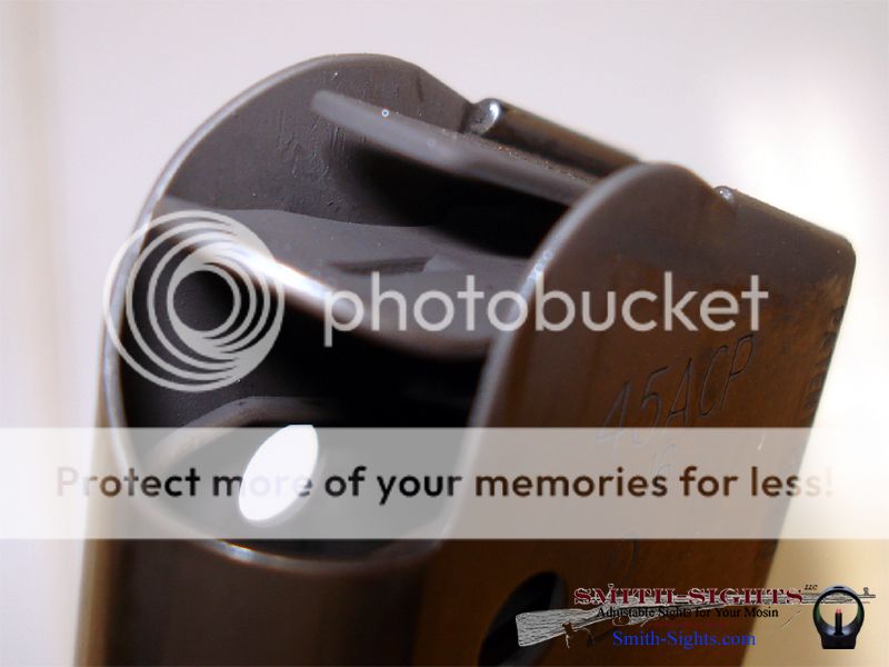

If I had my 'druthers, I'd choose a metal plate reinforcing the plastic base plate. There is a metal plate there (which, incidentally, interchanges with Wilson), but it's only retained by the plastic baseplate and not the magazine itself.
