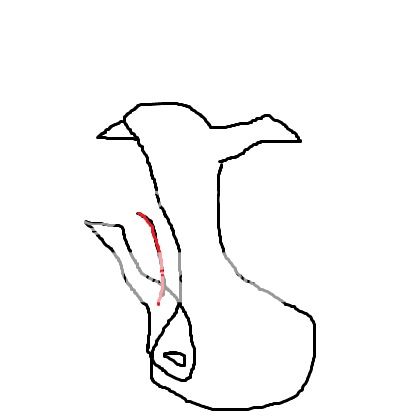

I used my mad paint skills...for us visual learners...
Hopefully you recognize the hammer.
The hand is the little black doflinker with the red line being the hand spring

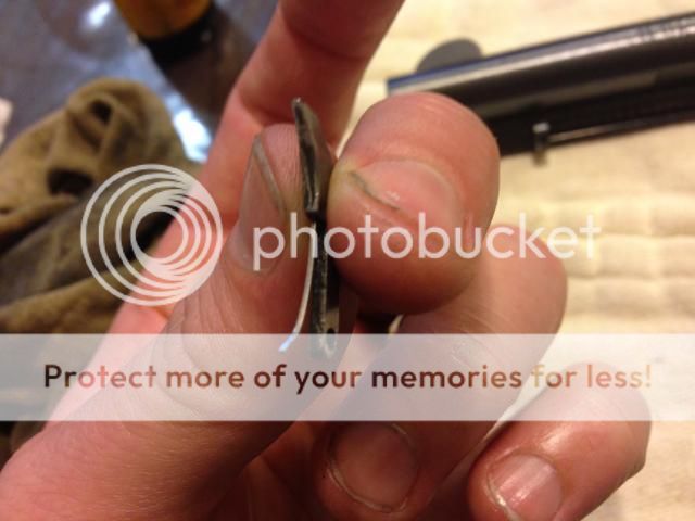

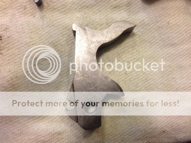

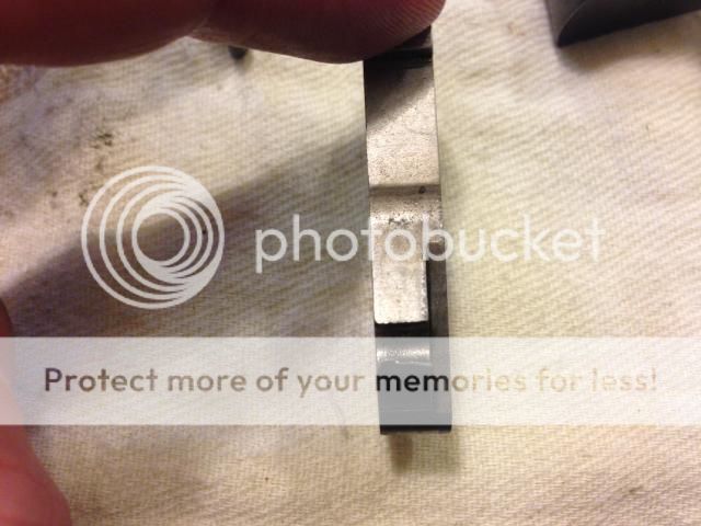

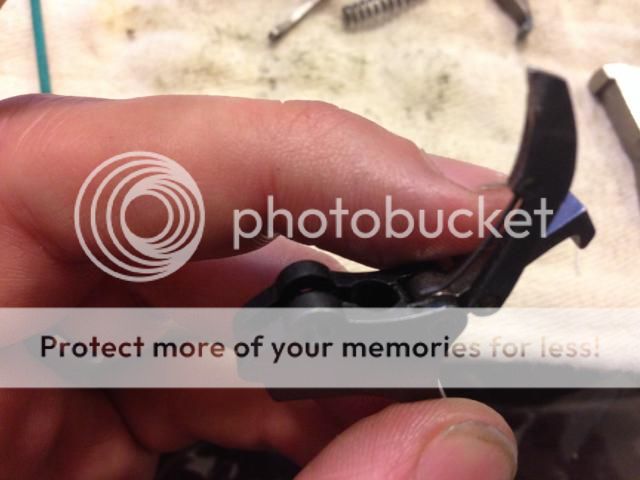

Well, finally located a punch the complete the disassembly. I think Echo was dead on with the part - which I think is a hand and spring assembly? Here are some pics:
It may not show up that well but the inside was disgusting (probably should have been taken apart anyway)
This is probably the problematic piece - as Echo and brotherockeye others pointed out - you can see the long skinny hand spring piece (I am assuming that this is what this is called) is bent off to the side a bit.
This picture shows where the hand and spring connects to the trigger assembly. You may notice a little hole that looks like the skinny spring piece should sit in. The spring was bent and not in the hole, rather it was jammed in the mechanism beside. Can anyone confirm that the spring is supposed to go in that hole?
Finally, I also noticed that the little crescent hole in the hammer has somewhat distorted (and/or some metal has been sheared off). Is this causing any of my issues or would the issues be only with respect to the hand/ spring mechanism? To be honest I cant remember what that crescent hole interacted with - so I am not sure if it would matter.

1. Yes, the spring is supposed to go in the hole. Works on tension instead of compression. (pulls the lever forward) Yours has popped out, caught on something and bent. You can try to straighten it out and reinsert. Worse case is you end up back at square one. BEWARE!!! The spring may be work hardened and brittle. Check the bottom of the spring. If it looks jagged, odds are a piece has broken off, allowing it to pop out of the hole.
2. The lever for sure. The hammer is up to you.
3. With a bit of calling around and scrounging, you might be able to find these in Canada. Otherwise, there's Numrich in the States.
These are the two parts right from Numrich's website: hammer lever and spring <<click on the links - you want the "C" version of the lever.
As warned before, the parts are cheap......it's the shipping and processing fees that add up.
4. Best of luck!!!
