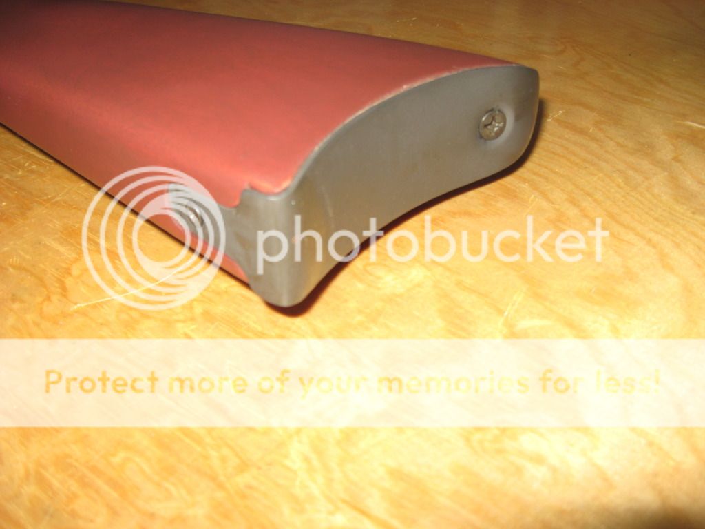

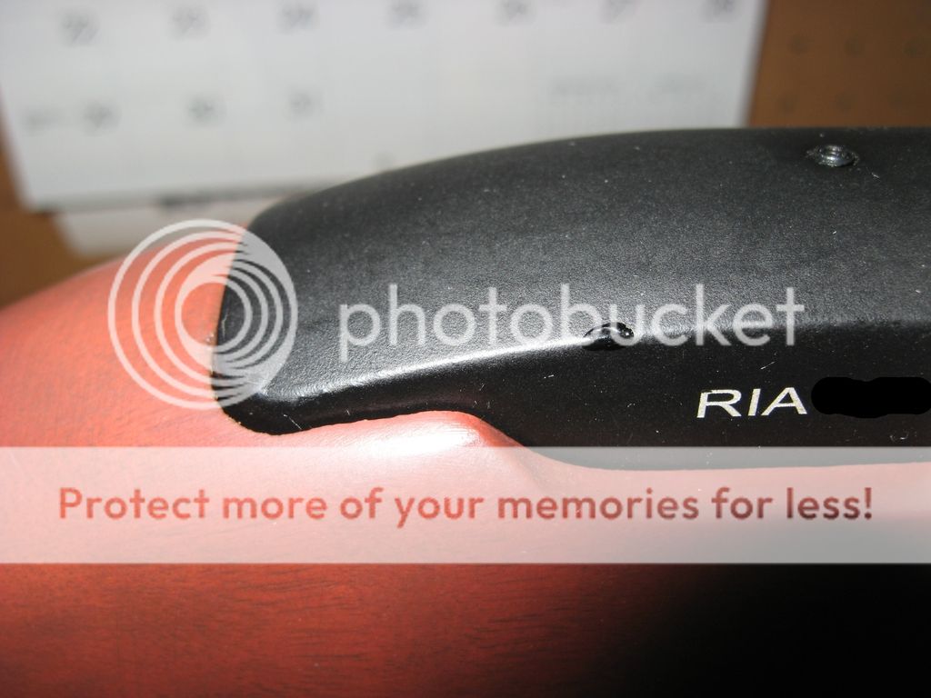

When I pulled the rifle out of its bag, I noticed that it was well oiled to protect against rust. A quick look over revealed a millimeter wide chip in the finish on the top of the receiver. I also noticed the the finish had been worn on the edge by the charging handle. The undiscript wood and finish is adaquate at best, slightly above the one of my Chineese SKS. Knowing that I'll probably upgrade to a synthetic stock helps with the small crack showing near the mag well.

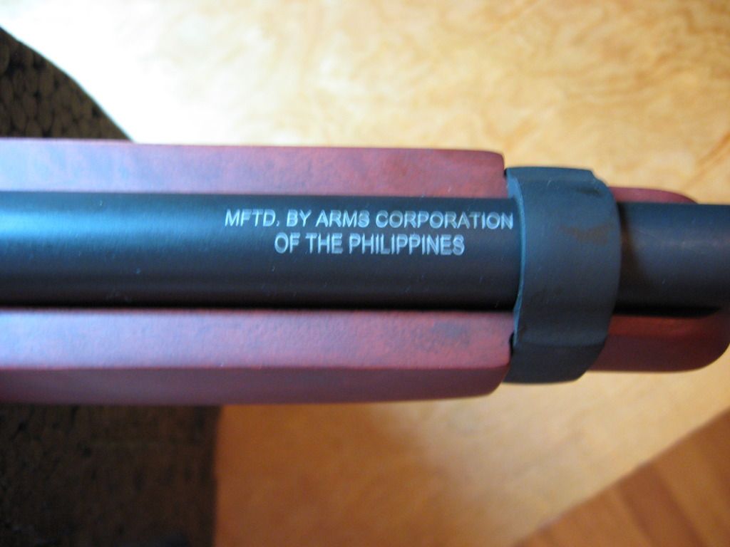

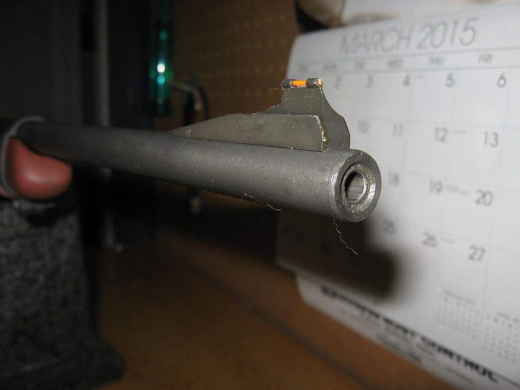

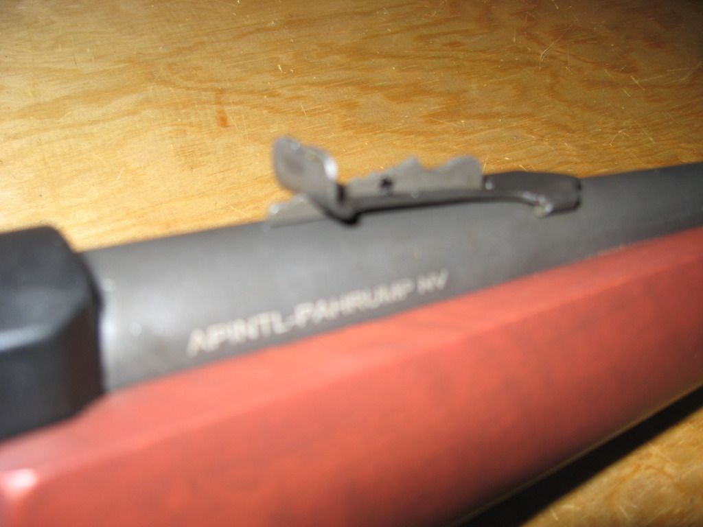

The barrel seems free of defects and has a recessed crown. Armscor replaced the military style front sight by a hunting style fiber optic aperature. I liked the idea, but the fiber is so short, that it struggles to capture enough light. The rear sight is adjustable. There was some play in the barrel band and it's screw, along the the action screw had slightly marred heads.

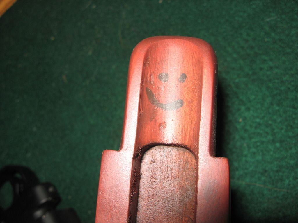

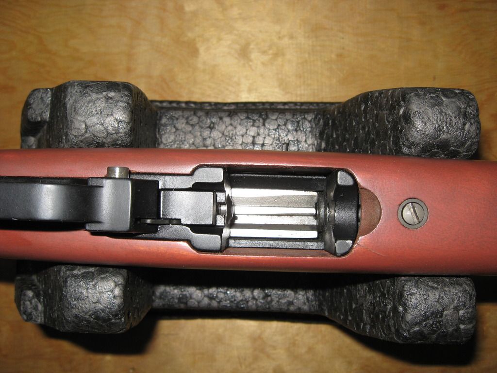

Reading the provided manuel, it says that the rifle is ready to shoot out of the box, following a cleaning of the barrel to remove oils. I decided to remove the action from the stock for a more in depth inspection. I found several more chips in the finish on the lower part of the receiver and a surprising amount of left over saw dust in the stock. Someone along the production line also managed to draw a happy face in the inner portion of the forend. It actually made me smile as I was baffled at the finding!

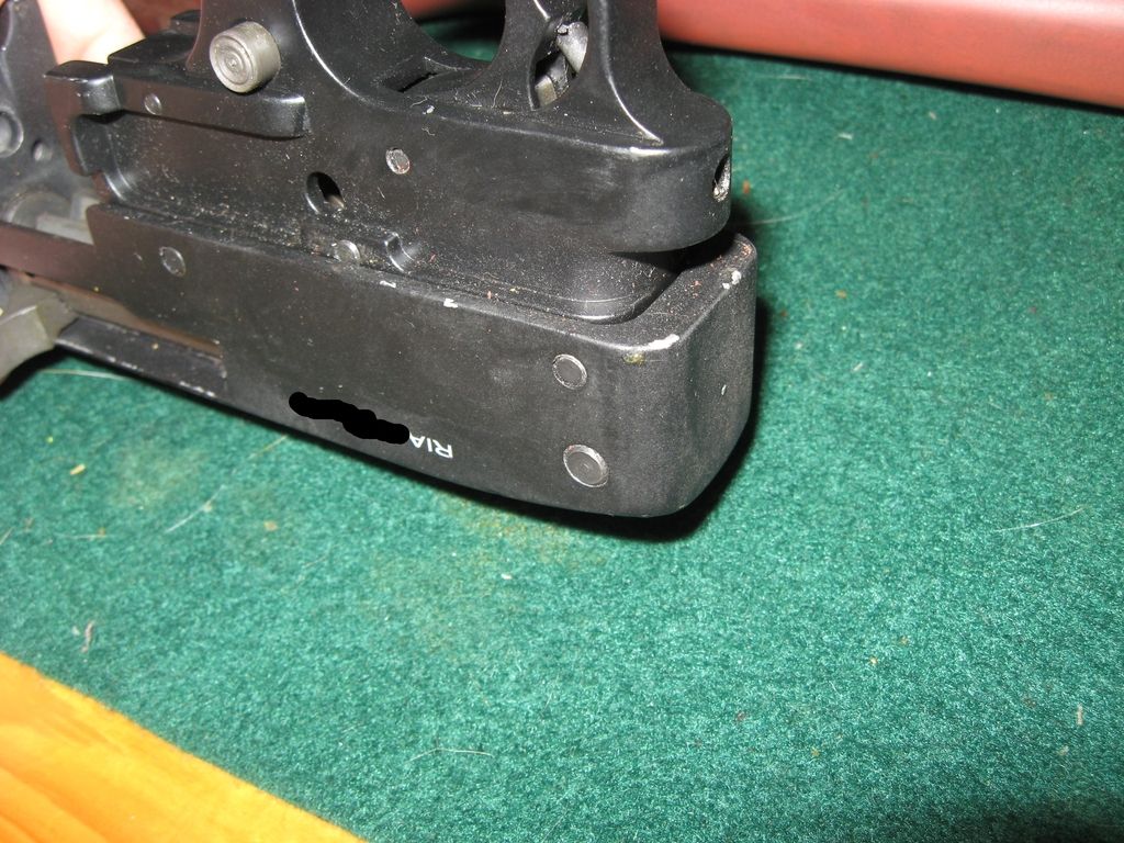

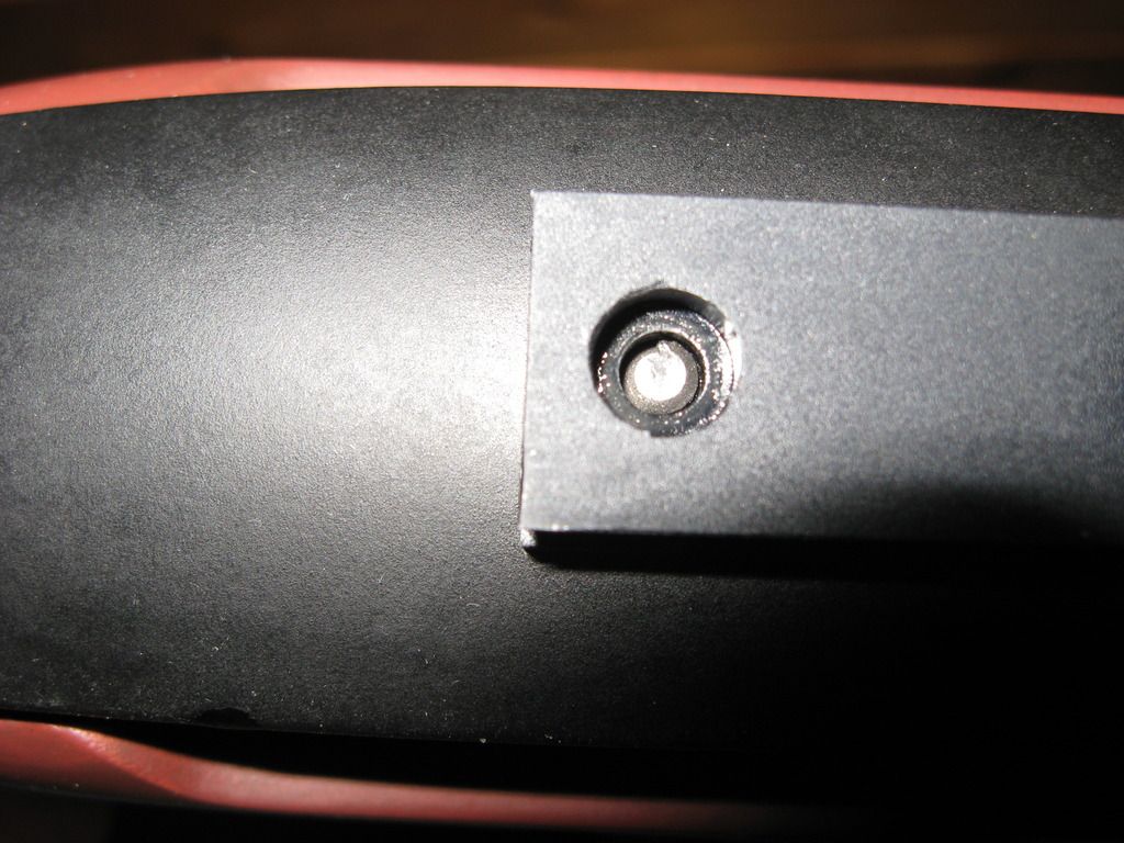

Ok, well I didn't make it out to a formal range. I managed to try out the little rifle from an improvised rest that was not ideal. It was pretty windy and about minus 10 Celcius to make things better. I just needed to get out of the house and put it to test. I did not set out with the idea to mount a scope on it on a permanent basis, but since I had a spare 4x scope available, I decided to throw it on for accuracy testing. I torqued down the rail mounting screws to 30ft/lb and everything went fine, until I went to remove it and a screw head broke. Crap, but at least I was done testing the scope.

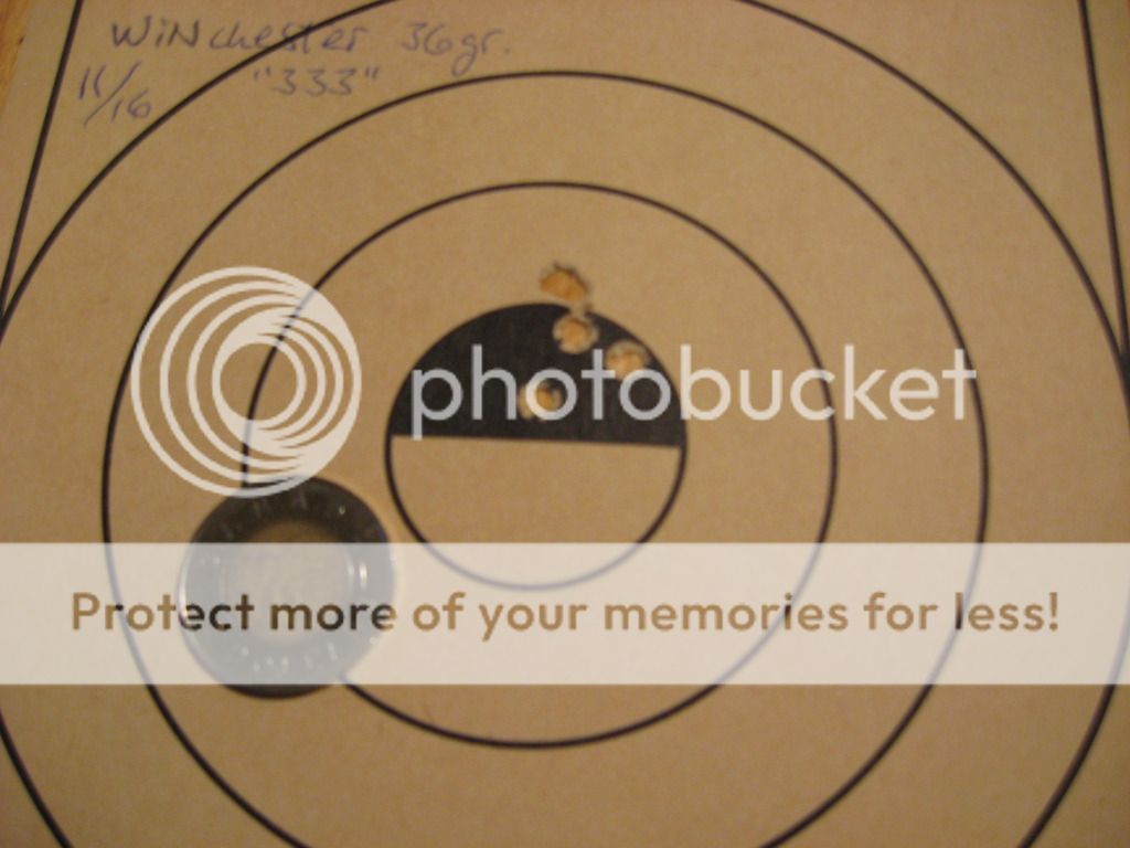

All groups fired were five shots at about 25 yards. For some reason I kept getting vertical stringing with the CCI. I managed to repeat a few 1" groups with the Rems. The Winchester "333" were excellent providing regular groups in the 3/4" range. They were so accurate, that I could get 1" groups with half an effort, including rapid fire or using the iron sights. I'm sure I could best my 11/16" group with the Winchesters if I had a better rest and better weather. Both the 10 and two 25 rds mags fed like a charm. I did load them about 24 hours prior to season the springs. I could also pop my little Duraseal gopher target time and time again, offhand, just with the ironsights. This little rifle was so fun, I had a hard time putting it away.

I contacted O'Dell Engineering who is the distributor for RIA about my broken screw and this is the reply I got: "We currently do not have parts to support the RIA 10/22 clone." So buyer beware !
