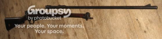

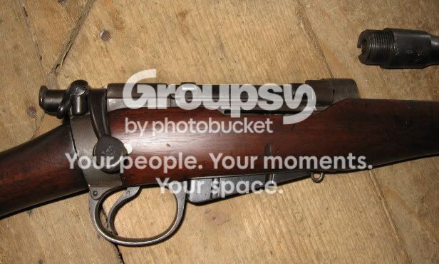

Restoration project in progress. LEC Mk.I* This is how the project started out with just a receiver.
What are the chances of finding a spare carbine barrel? Slim or none?
Probably most practicle way would be to spin a rifle barrel in a lathe and reduce it to carbine profile. The front sight would have to be hand fabricated and added.

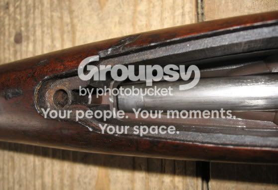

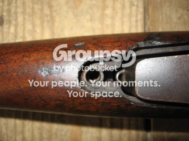

There is a different wire loop on front of mag that sits ABOVE trigger guard inside the action, the front wood in the mag well is relieved to take it.
What is the idea behind this? No room for an external loop? How is the mag removed for cleaning?
Yes, the mag is six rounds. It was taken from a RIC carbine (which is yet another project). The carbine appears to be complete and original so I would assume that the mag is original to the carbine also.
I have not encountered a loop on a mag like this before. Once installed above the trigger guard, the loop makes the mag captive and cannot be removed from the action without removing the trigger guard.
Obviously fa actory installed feature so I will leave it the way it is.

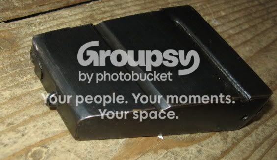

Here's a picture of the mag (complete with attacking link) from my original RIC carbine, which would of course been identical to the arrangement on an unmodified LEC. Not the optimal arrangement, but I guess they were afraid of the average Private / Constable losing their mag (which is only partially stupid, when I did basic we DID have a few troops lose some weapon parts).
I guess to clean the thing you just took out the spring / floorplate and left the mag body attached. Kinda like keeping a C7s heatshield spotless while being told not to remove it from the handguard :rolleyes: .
