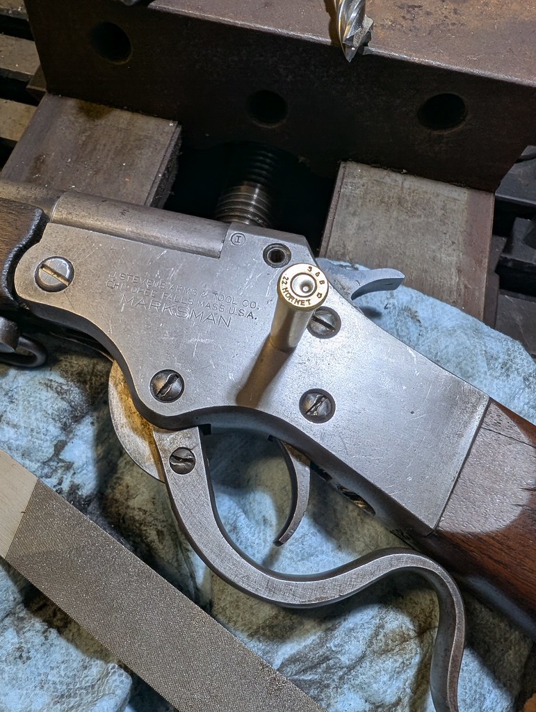

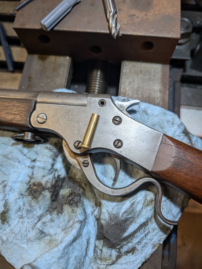

i picked this rifle up a few months ago, i wasn't sure what i was going to do with it but it was a good deal and in good shape. After reading about the 25 rimfire and reading about making ammo for it, i thought about making a center fire version of it using 22 hornet brass. i trim the brass to 28.5mm long and expand it to .249".
it took about 10 hours all said and done but it was a fun project and everything just went really well.

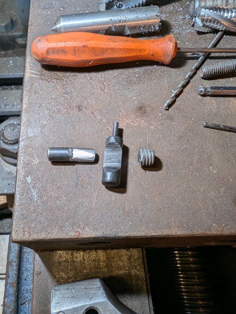

the changes i did to the rifle were

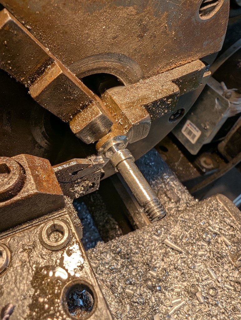

-made a new over sized hinge pin out of 4140

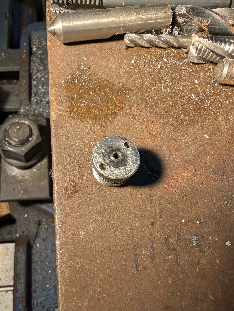

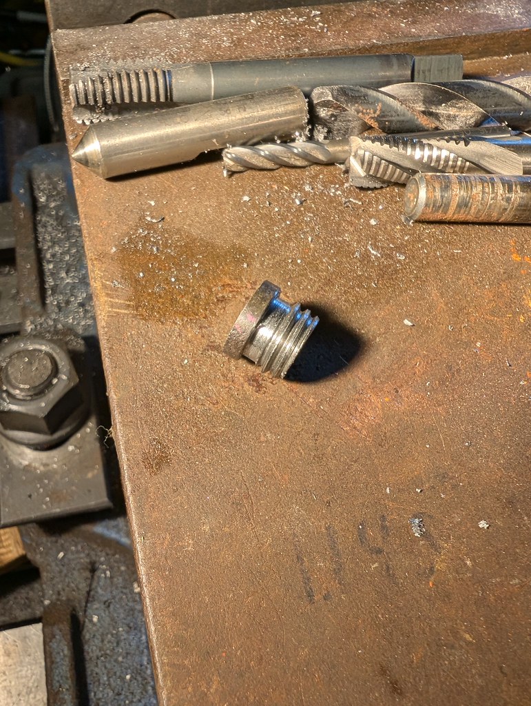

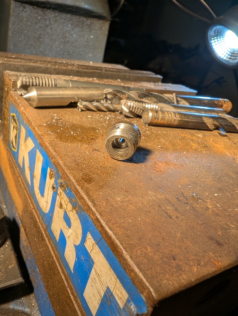

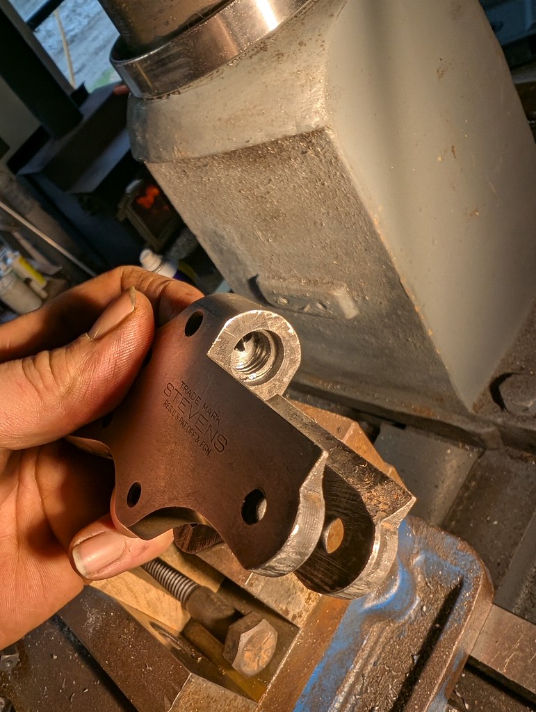

-made a firing pin bushing to make me a new surface to work with out of 4140
-drilled and tapped the receiver for the firing pin plug/bushing

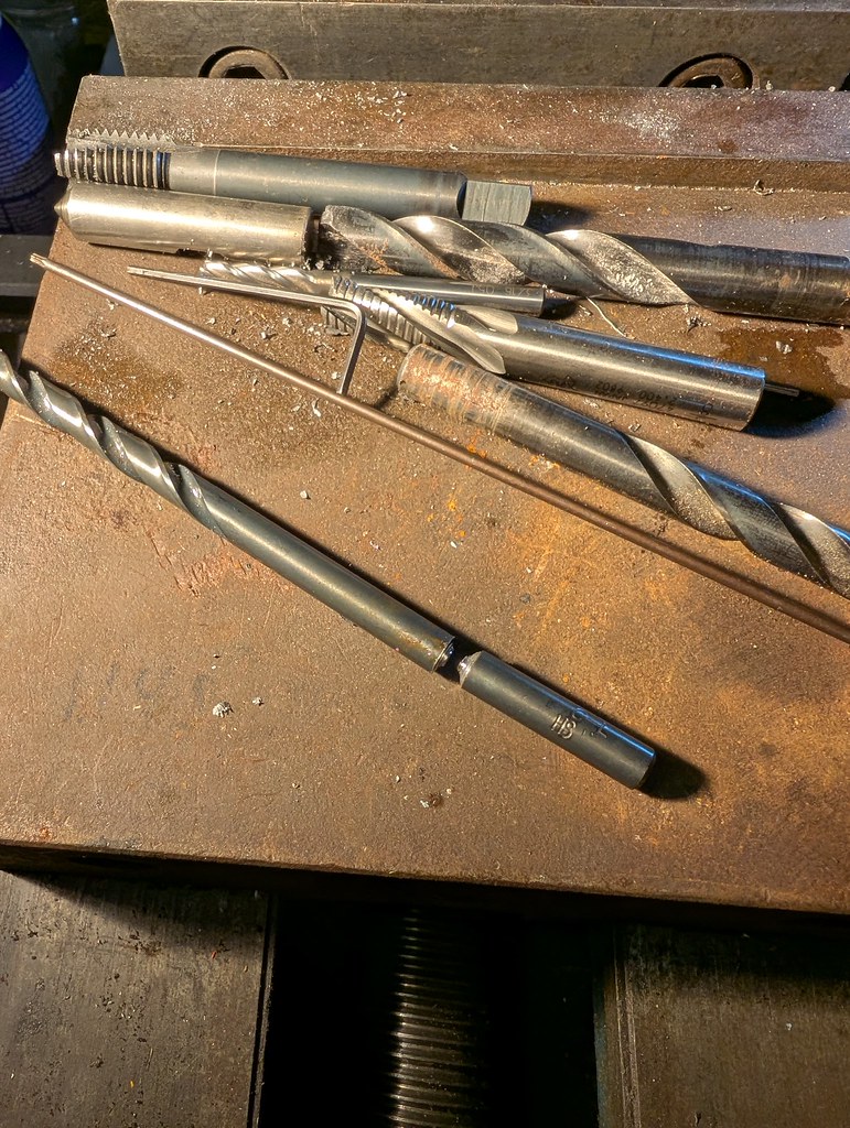

-drilled in the the back for new firing pin, stepped the size up to 6mm from 4.75mm but tipped the action so the hole would start in the same place but come out on center

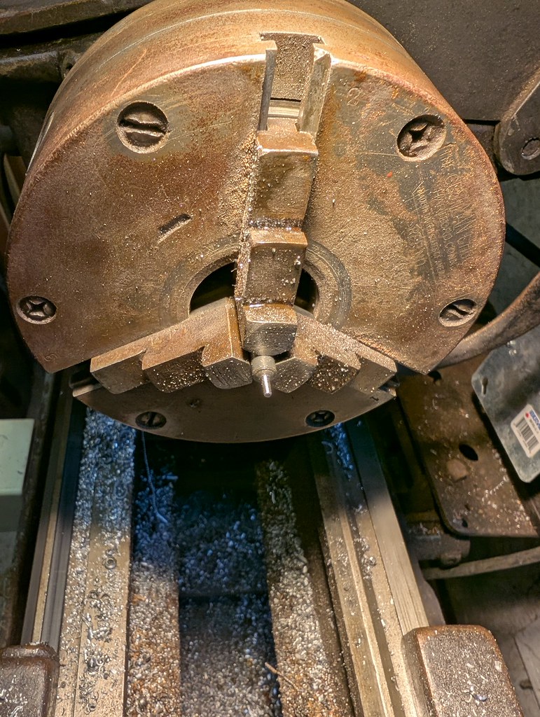

-made a new firing pin from the shank of a drill and hardened it
-made a 2 piece firing pin retainer so i wouldn't have to move the hole location in the receiver.

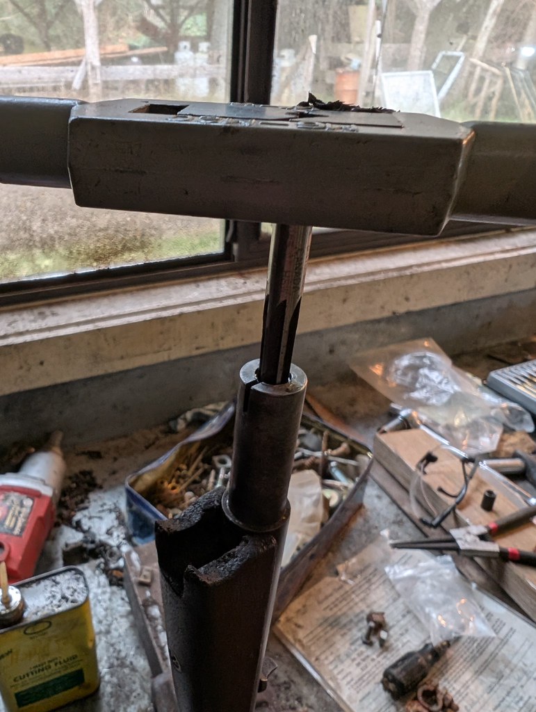

-made a chamber reamer and reamed the chamber. the chamber was straight .280"at the base and mouth, now its .300" at the base and .280" at the mouth.

Yeah, some rifles it's easy to switch, this one not so much. But I'm very excited to have this done. I love the idea of a 25 stevens CF.
I'll make a die for resizing the brass. I just found some .252" 50gr cast bullets. I hope to get 1100 fps out of the lighter 50 gr bullets opposed to the normal 65gr.
