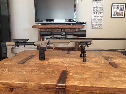

Mine is a CZ 453 American with. DIP 25 Moa base and Burris XTR rings with another 25 Moa added. Leupold VX-2 4-12 CDS with a Fine Duplex. Harris bipod because I don't have the heart to drill holes for a pic rail.
After zeroing at 25yd I took it to 290 yd with 48moa dialed. Then out to 360 yd (65moa) and eventually 400 yd. I run out of travel at about 375 yd so I just held the rest at 400 but for a cheaper scope I'm happy with that.
I was really looking forward to see how well this scope was going to dial from top to bottom and back. It didn't disappoint. And I dialed back down to zero and it was bang on.
I'm using SK Standard + and getting 1040fps.
So far Applied Ballistics has been bang on with a G1 BC of .135.
I'll be trying smaller steel next time out but the wind was pretty strong on my initial scope test.
