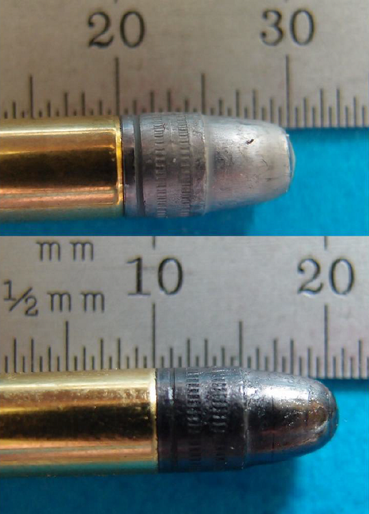

The problem may be more to do with the bullets involved rather than the rifle's headspace. It may be chamber length, but perhaps it's something else.
Eley EPS bullets and Lapua bullets have "drive bands" that are different. The Eley drive band is not as long as that on Lapua bullets. Below are pictures that illustrate the difference. The shooter who posted these images in 2017 on rimfireaccuracy.com says the Eley drive band is about 0.5mm (or .02") shorter. This means the Lapua bullet will engage the rifling before the Eley bullet.
The headspace should be such that both Eley and Lapua (and other match ammo) can be used without issue. As no one knows what ammos will be available and their pricing in the years to come it doesn't make sense to restrict a set up needlessly to somehow favour one brand or another. A safe headspace will not affect accuracy nor will a tighter than necessary one improve it with any make of ammo.
As others have noted, the chamber may be too short in length. Alternatively, the leade is too abrupt, with its angle not sufficiently shallow.
The Eley bullet is on the left in the picture below.
