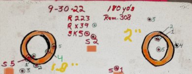

Have you been running into these guns 'New' from vendors or are they used ? If 'New' then did you get a 'second opinion'? Maybe the 'rings' are not from 'obstruction, but just manufacturing variances? I've never had one But I did buy a New Ruger Ranch in x39 that had a couple 'Bad looking' spots in the barrel, like a chunk of debris got caught up in barrel during rifling. I chose to fire it b4 going for warranty - I didn't want to go without for xx weeks as Gravels wanted me to 'send it in'. I fired it and I can get around 1-MOA out to the 180 yd my range has. Here's the worst of 3 spots in that barrel. And then 'chatter' marks thru much of the barrel. Didn't seem to affect accuracy, unless it could have been better w/o the 'damages'. And one of my better targets with that gun and a '51 Tula with irons.
