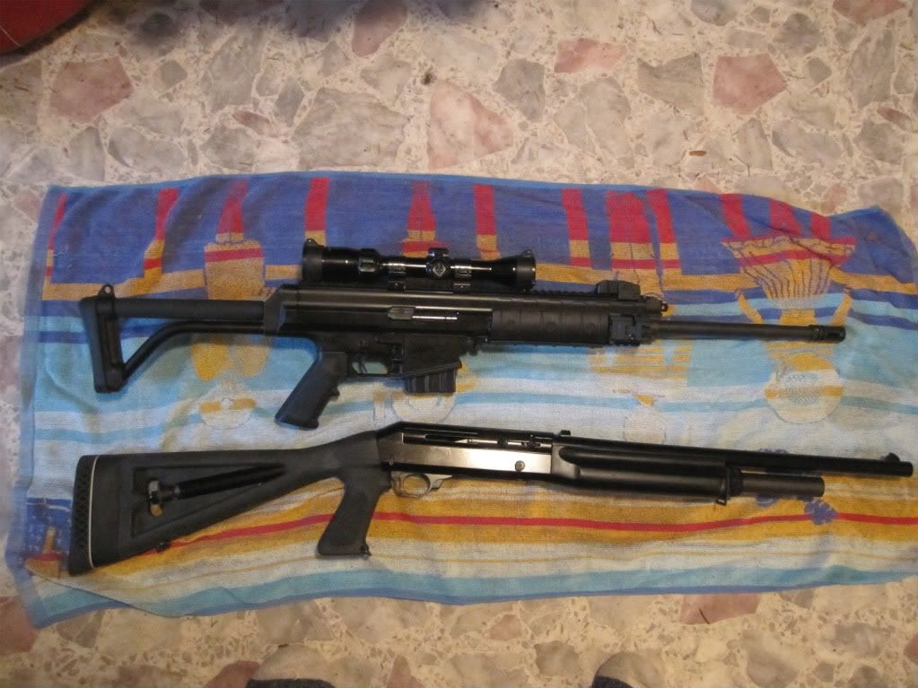

Heres my new toy in 6.8. First by itself and then with the new family.
And with the Family....
Now, just waiting for the scope, and a new Tavor... :dancingbanana:

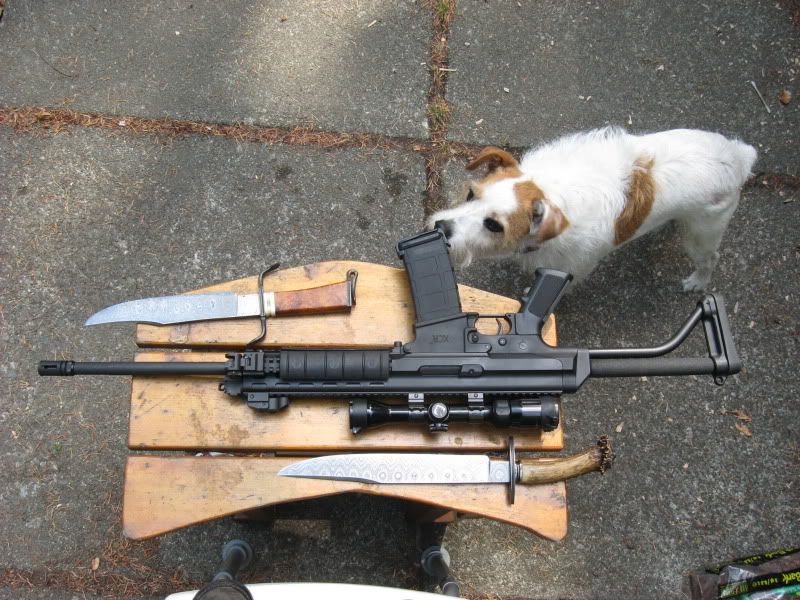

It seemed a good place to store the sight, w.t.h. they're rails may as well use them.
I'm just waiting on a T-pod, a rail sling loop, and rail light mount, along with a new trap door pistol grip, to arrive from Fab-Arms in Israel.
They make great stuff.
Here's my nice pair.
I like how you popped the rear sight onto the rail I'm thinking I will be copying you when I get my XCR.

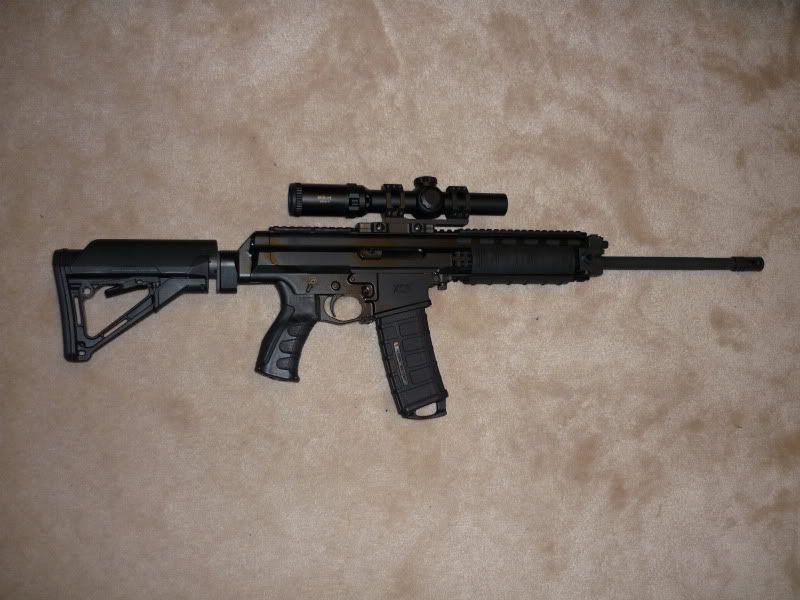

Here is mine with the new CTR and cheek piece on
