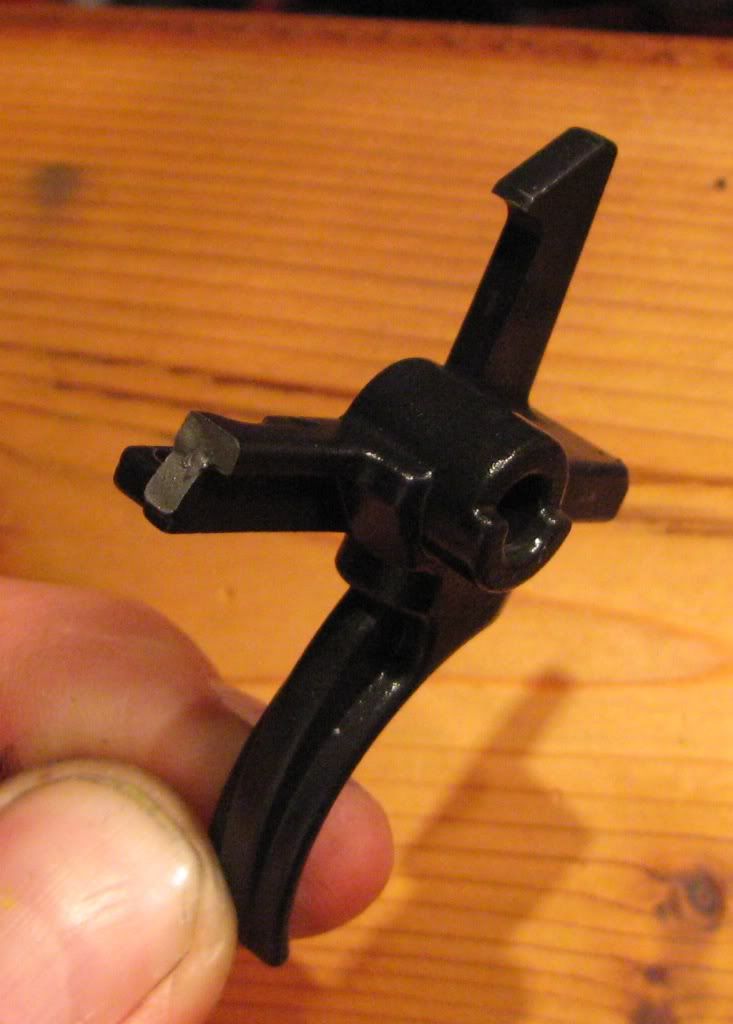

Once I have this thing apart I am going to measure it, image record the internals, and draw up the trigger. I am then planning to machine one up with a custom design, out of T6 7075 billet to match the trigger I've got on my Nighthawk Custom GRP. Comments or anyone wanting one? Not sure when I'll get it done, most likely be this winter. (and no I will not be sharing any part information on line to piss off the boys at Robinsons Arms, I'm sure this thing is copyrighted)
I was thinking of doing the same thing, except dont use aluminum for the trigger. The original seems to be fine cast or sintered.
If machined it should be hard steel or machined and hardened
I disagree, 7075 T6 aluminum is very tough stuff. I've been in the machining/aerospace industry for many years and have made countless things from it. Half of my damn race bike (highly modded GSXR1000) is made of the stuff too and it takes more of a beating than my guns.
The original seems to be made out of some kind of cast aluminum as well. Basically the trigger/safety mechanism is a failed design and to not make it from billet is a fail too. I'll never be able to put any faith in it ever again until I succeed in making it better. Thinking it could be made from titanium as well, have access to plenty of that! I'll have to test and see which has better wear properties for this application. Hardened 7075 T6 or titanium either would be better than what it has now.

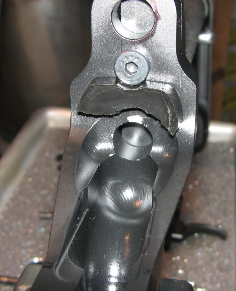

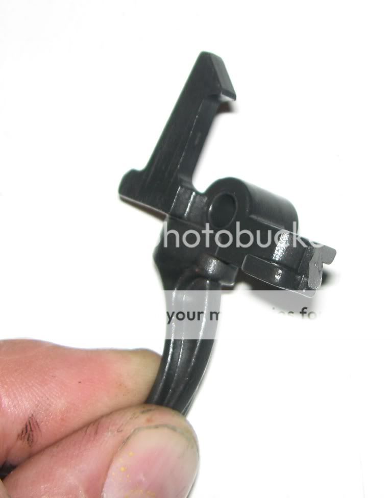

Sent these images to Wanstalls so that they could order a new trigger for me. Lets see how long this takes to get a replacement from the States, not holding my breath this time but am hopeful.
Trigger is definitely made from some light weight cast crap. Such a shame, these guns are not cheep, why the cheep parts?

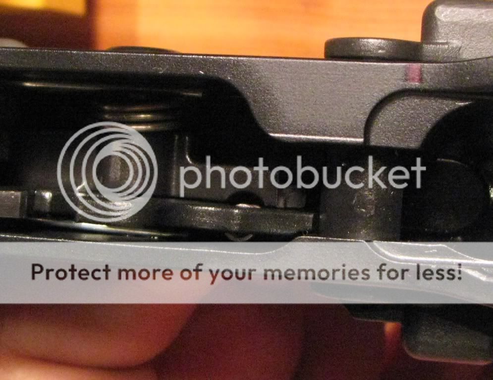

You can see the damaged buffer and the small chip that the loose piece of trigger put into the heal of the gun under the buffer.

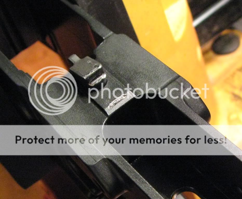

Already allot of wear on this action release as well, wonder how long it is going to last.
Anything you use would be better than the #### RA uses ...
The only advantage titanium has over steel is that its lighter at given strength and doesnt rust.
In a trigger I would want a hard surface for the parts that engage so they dont wear off. In your race bike there arent many moving parts that touch made from aluminum. Maybe your cyilnders are but they may have sleeves or coatings. The frame is probably alum but it has probably steel sleeves or bushings where moving parts attach
Either way.... My trigger broke as well and I since distrust the gun :mad: I have access to NC equipment so I may go to town on this sometime this year.
