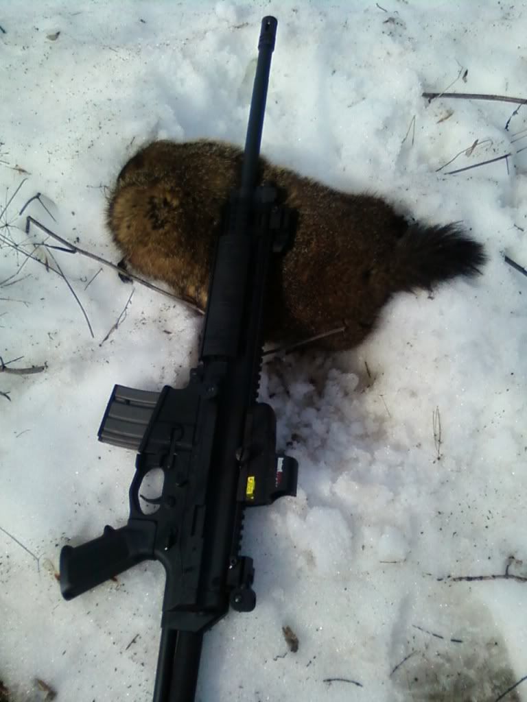

Yes I do...
Going to try it with my 6.8SPC upper installed loaded with 95gr TTSX this year as well...
Holy schit you need some of the LAR 15 10 round pistol mags those 5 rounder mags just aren't cool or fun... :p
They would be a no-go for hunting with the XCR in Ontario (5 Round Semi-Auto Max). Now that being said I do have the LAR 15 10 Round magazines for hunting with my Remington 7615 :).
